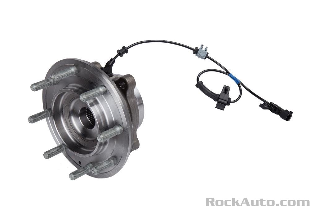

my younger son brought the truck back yesterday afternoon and said it went from making a noise to sounding like the drivers side front wheel was going to fall off within 10 miles. it has alot of play and is clearly bad. i've only done older model wheel bearings- it looks like the modern stuff is pretty simple, just bolt on and deal with the wheel sensor wire. the parts store has a carquest brand hub in stock. i've got no experience with carquest parts and not sure if i need to look around for moog or timken or just go ahead and get it done which is what i would like to do. anybody familiar with carquest part quality?

The hub and wheel speed sensor will be an assembly. They are easy peasy, pull the wheel, pull the caliper and rotor, pull the nut for the cv shaft and pull the 3 or 4 bolts on the back of the bearing and the sensor plug and it all comes right off. The dodge ones are the difficult ones that seize in the knuckle. Been a while since I did a GM one but they were easy. Just don't buy the cheapest part they off like a broke high school kid and you will be ok. I rotate between Carquest and Napa for all my fleet parts and they are both good.

I thought I remembered from the videos that the sensor came with the hub. Thanks, gonna get it done this afternoon if I have time
I bought AC Delco hub assemblies from RockAuto for my dually.

These usually aren't difficult to swap. If the hub cover is on, it seems to help a good bit to minimize rust at the axle spline.
I have done many. It is a 1 hour job if everything goes OK. Buy the socket for the hub nut and make sure the new assembly comes with a nut. They are a 1 time use and not all hubs come with one. And I beleive the torque is 440 foot pounds. So a 2 foot breaker bar with a 220 pound dude standing on it.

Hub cover still on. It wasn't bad, just getting the old one off with the boot in the way. Need to upgrade my sockets and get a lift
I did have to buy a 35 mm socket, my metric set goes from 32 to 38 for some reason. I'll have to get a new nut. The hub didn't come with one. The new one is on, just have to torque everything and reroute sensor wire. Thanks for everyone's input
