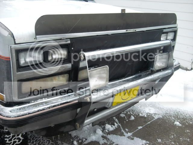

You mentioned cover plate...
I know i'm not living in the arctic, or far far north, but with my current cooling setup, this has helped alittle, as mentioned i am also running a trans cooler, pretty decent sized unit in front of everything on the radiator, there is also a factory oil cooler on the other side.
I don't know the temps, no temp gauge yet.
As mentioned in other threads, i was having issues with generating suffucient engine heat and maintaining it now, swapped out the old 195 stat for a new one, this helped alittle, but still not what i like.
I installed this a few weeks ago, and it will still run up to the t-stat level, but still cools off alittle too much when it opens, for my liking :D not staying up at the t-stat for very long.
I do notice it does warm up alittle quicker with this on, but i still have work to do... :tongue1:
I covered the grille only, so that if the engine DID need cooling, the fan could still pull air through the radiator when it got hot enough for the fan clutch to engauge. Unfortunately, with a heavy duty clutch, it's pretty much engauged all the time. :doah:
