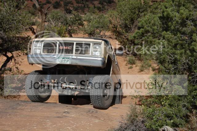

Here are pictures in action.

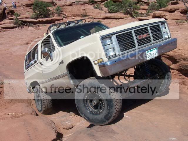

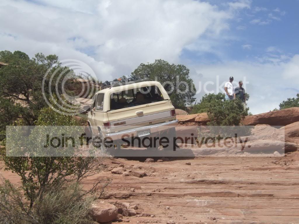

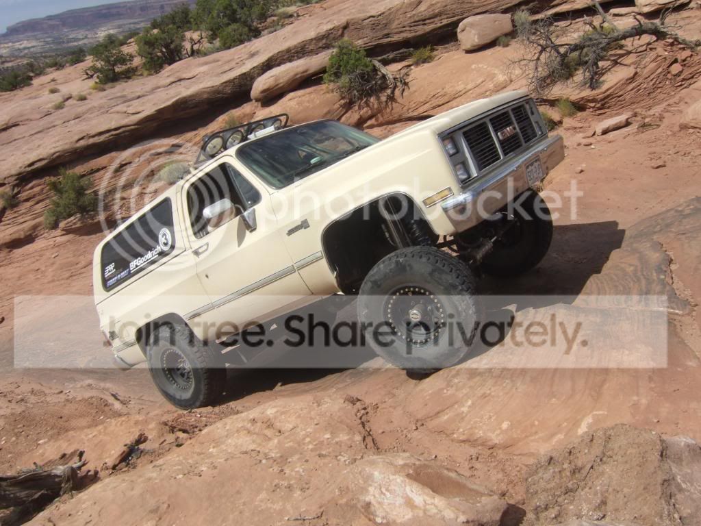

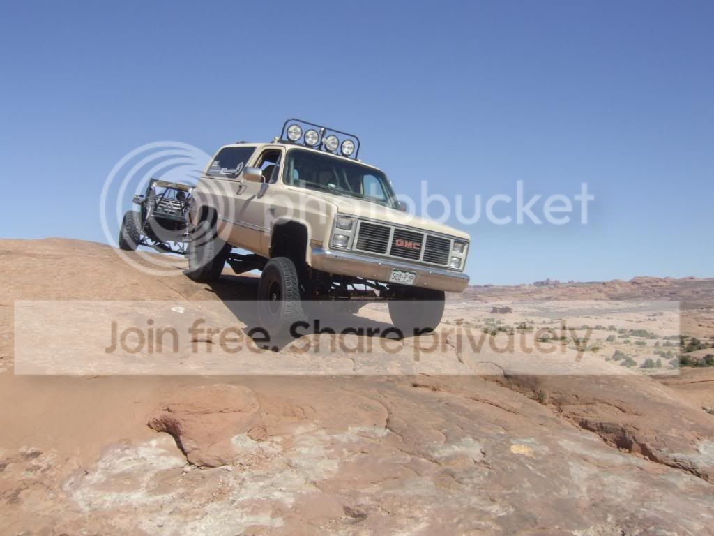

I took it to Moab in 07 for the first time. Was asked if I could make it stiffer.
Took home the Jason Payne award for most innovative vehicle at the BBQ. I had a blast. I did Hell's Revenge in 2wd. Just went a little faster.
So in 08 I tried harder stuff. It works well. As for articulation, I don't have any pictures with a wheel off of the ground, because they seem to stay planted. It has 18" of travel at each corner. I do the runs with 36 psi in the tires. There are some threads on here with info and videos, but I do not keep track of where.
