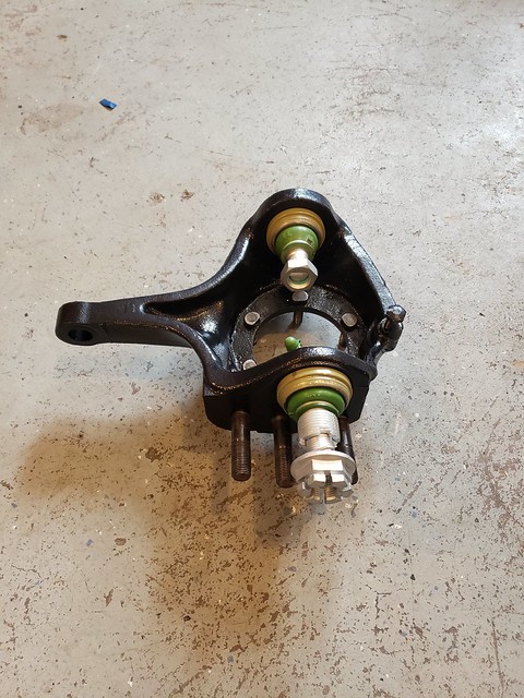

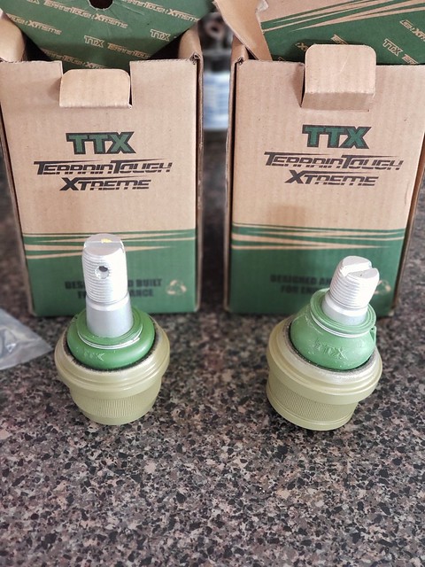

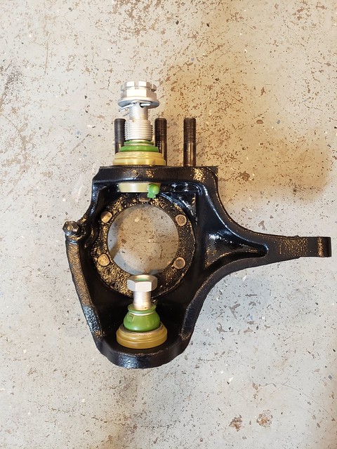

I was really impressed with the Mevotech TTX balljoints I just installed in a D44 for my K5 build. The construction of them looked top shelf. Even the packaging was well thought out. I also like the fact the upper balljoint is actually greasable
For a late later 70’s D44 the part numbers are:
TXK8195T – Lower
TXMS50569 – Upper
notice them mevotech units look like a moog but green boot . . . heard the guys behind these are ex-moog guys and there making the real good stuff that us gear heads like to buy .
