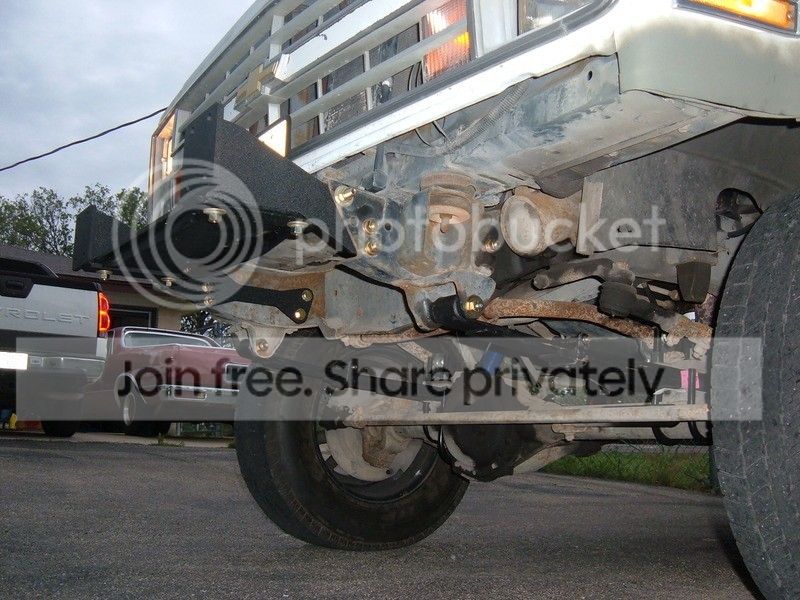

Got a bunch of work done.........................
Superlift 2.5 front springs and u bolt kit from Summitracing
sway bar pivots from Zone Offroad
TNA front spring shackles
DIY4x greasable bolts
rear spring shackle flip from TNA
front lifted modular winch mount also from TNA
fang removal
Monroe shocks (31131 for rear and 33084 on the front, just had to change bushings)
17x8 steel rims rocking 265/70R17 take off tires

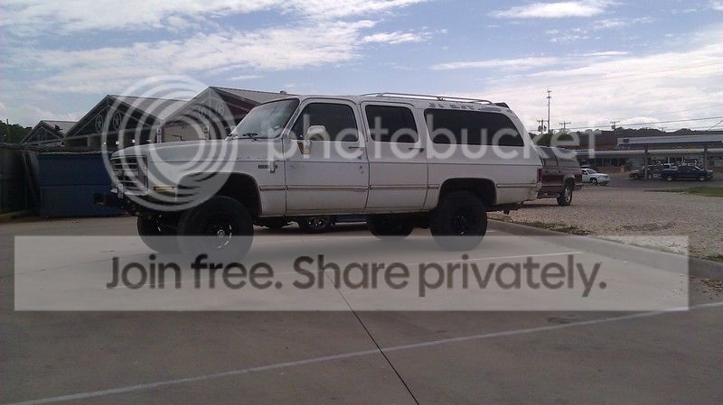

A nice in town pic................
