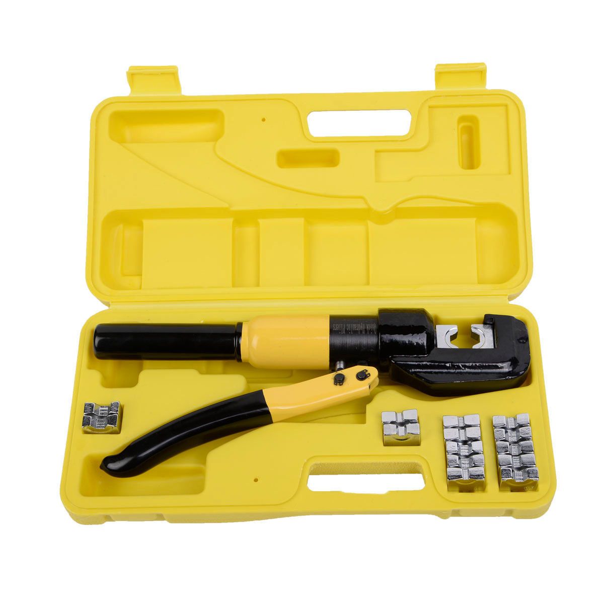

I've had good luck using one of these type of hydraulic crimpers, then solder and shrink wrap.
