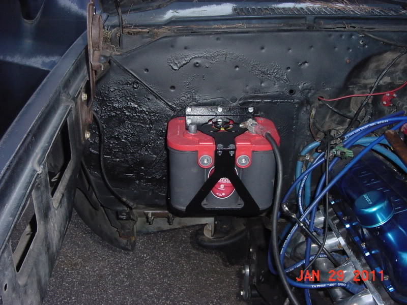

I had mine mounted in a ruffstuff box mounted inside a tool chest in the back of my k5. Not sure I’d do it again that way. Now I have my duals in the engine bay where god intended.
Dimple it.I am leaning that way, but I need a solid mount that wont rip out of the firewall. Going 50+ through 1- 2 foot whoops shakes crap big time.

When I had my diesel k5 I had my 2 batteries where the console used to be.I'm running a single in my '82 behind the driver's seat. Have run duals back there but a single has done the job for me lately. I figured that footwell area was as low as practical on the vehicle so was a good place to put the lead chunk. Tools go in that same well on the passenger side for the same reason. Keeping weight low on the vehicle is always a good thing and will make more difference than you think. If you keep it in the engine bay, mount it to cage/chassis material and as low as you can on the firewall. There's no sheetmetal that will last when you know what the word "whoop" means. Keeping it low is obvious and keeping it toward the firewall helps it see less force from pitch movement and takes weight off the front.
