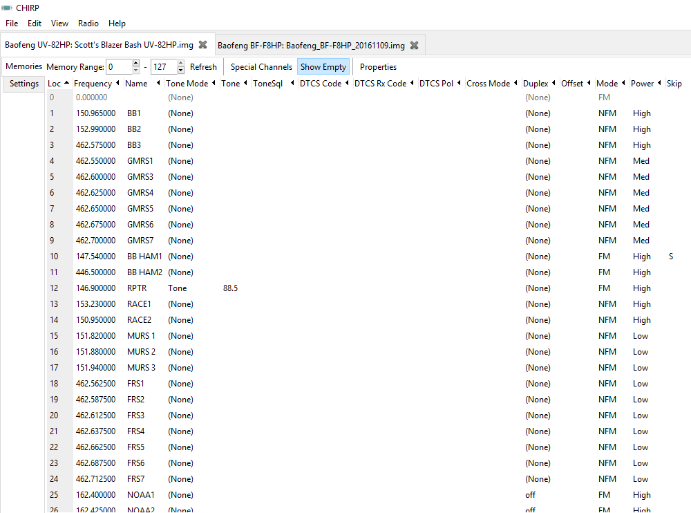

    Here' what I'm programming my radio with. Hoping channel 1 will work but we can use 2 or 3 if needed.
    [​IMG]
    The little cheap handhelds I have to share only work on the GMRS channels so they will operate on channel 3 on this list. My radio is dual band so I'll have it tuned to channel 1 and 3.
    See if this works. It's a link to the CSV file you can use in Chirp to import to program your radio (I hope). https://www.dropbox.com/s/5kgu7d9nt45xqaw/Blazer Bash.csv?dl=0
