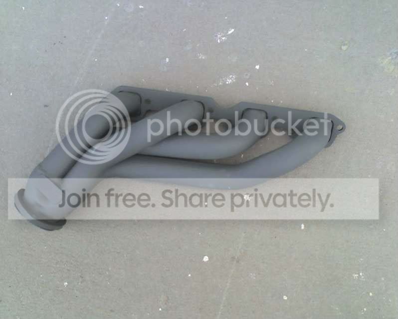

Update -
I went with Sanderson Headers, they were the only company I found that offered shorty's specifically for 73-87 body style trucks. I checked and they are a perfect fit with room to spare. The quality is far beyond what I expected, easily the nicest headers I've ever bought.
There is one thing I'd do differently, I should have ordered the ceramic coated version instead of "bare finish". After weighing different coatings and paints I decided to go with Jet Hot which will end up costing me about $125 more than if I had just sucked it up on the initial purchase.
Anyway, now on to Jet Hot...
Jet Hot offers 11 colors, since only 2 specifically say either "flat" or "semi gloss" I assumed all other colors are shiney finish similar to the look of powder coating. Wrong! I found out the hard way that ALL colors offered except for sterling silver (chrome-ish) are FLAT. I mean flat like primer. :doah:
After talking at length to Jet Hot they have offered to strip & recoat the headers in the sterling silver at no charge. There is nothing wrong with their workmanship but I just don't want to spend that much and have them look like I used Krylon primer. So... I'm sending them back and will post new pics when they return.
I do have to say that Jet Hot has shown excellent customer service so far and is working very hard to make me happy with the final product. Once they're back with the new finish I'll post more pics both off and on the truck.
