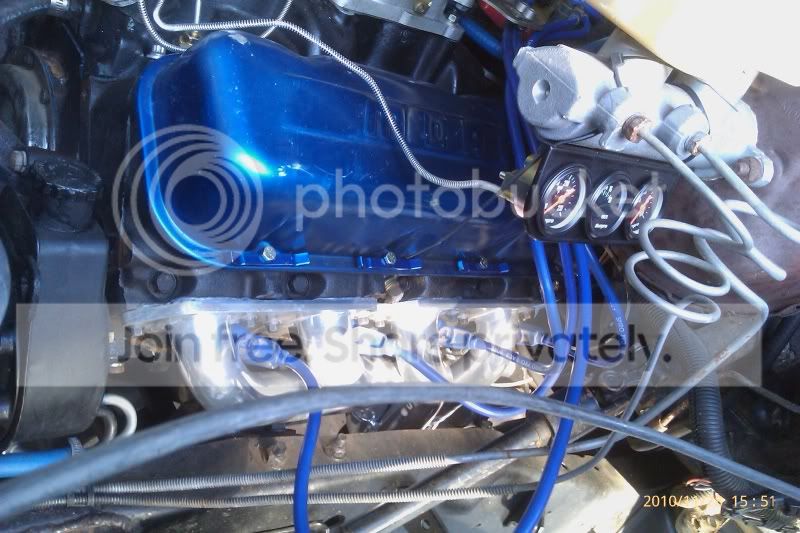

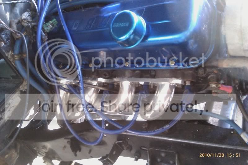

Yes, see post #19 - I bought some Sanderson shorty headers and they fit like a glove (no mods, no frame trimming, nothing). Here are a couple of pics -
Sanderson part # bb8
* Primary Tube Diameter : 1-7/8"
* Collector Diameter : 3"
* 16-Gauge Primary and Collector Tube Thickness
* 3/8" Thick Flange
* Patented Flange Design Requires NO Gaskets
