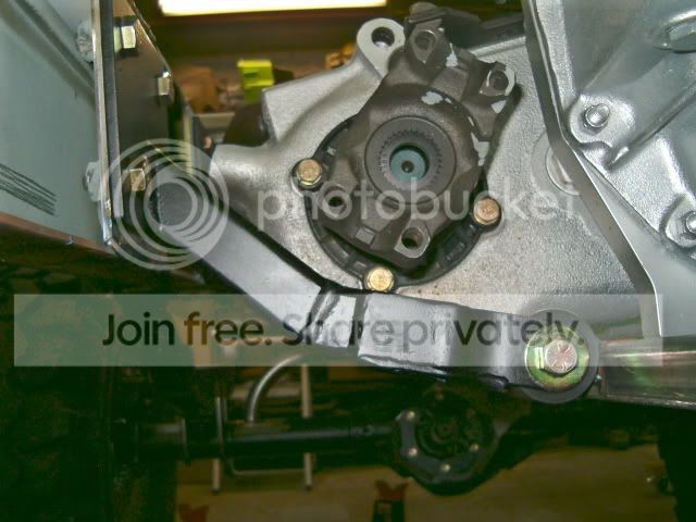

I am going to try to squeeze my exhaust through between the 205 and the frame. I will probably make an oval pipe through that section and rigidly mount it so it doesn't bang into either. I'm looking at a flex pipe connection between the header cone and that rigid mounted piece....well that's the hopeful plan right now anyway....my plans have been known to need modification though.
You can see in this pic of where I'm talking about: Its about 2.5 between the bolts of the cradle link and the 205 casting....it will be a squeeze through there I think. I will also have ~2" body lift on my truck.
I've also considered cutting that protruding brace mount off the 205 to give more room too.
