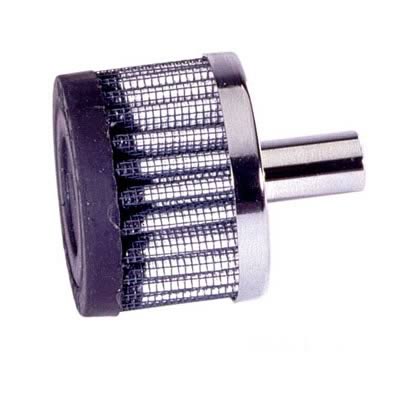

Did you source the breather filter locally?
Got a part number/source for that?
Thanks
The breather is a small K&N push in. Thease valve covers use a 1/2 hole for the newer style breathers that connect to the aircleaner.
K&N makes a 1/2 pushin that fit perfect:
KNN-62-1010 is the part number and I got it from www.summitracing.com fer 22 bucks. I little bit pricy for such a small filter but it did fit perfect so...it's just money anyway :D
