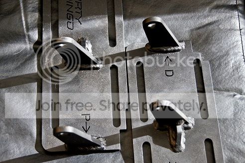

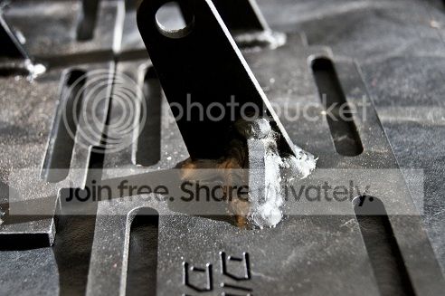

Great we have gone from crappy welds to crappy design. Why not stick with the design they had and hire a Decent welder?? Now this design is probably worse than the previous with bad welds.

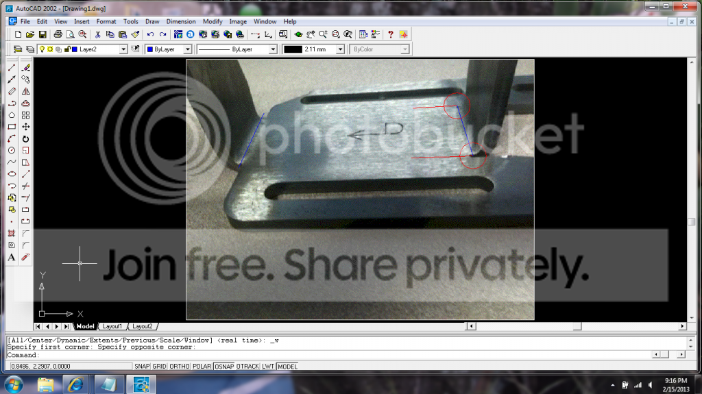

The Red circles show were the end points of the cut, these pts ARE going to cause the metal to rip/crack. The red lines show were the metal will fatigue and eventually rip/crack. The blue lines are were the uprights were bent. Since they were bent they are likely to bend again, one direction or the other. This design change took out the gusset that kept the uprights from bending...bad idea

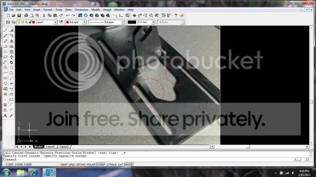

In this picture the red circles are showing were cutting out that upright has left the base plate very weak and could possibly bend.

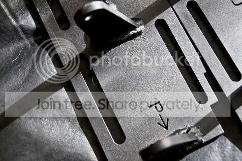

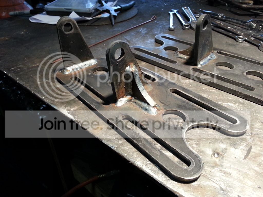

Here is my version. As you can see its slotted, that seemed like something you guys really liked about the other mounts. This is a set set i made for a guy on here and this is the only pic i have of them. Mine obviously have good welds, bigger gusset, the uprights are wider for more strength. The big cutout on the end wont be there on any others i make, Just a few speed holes, cause they add 5HP each right?? LOL

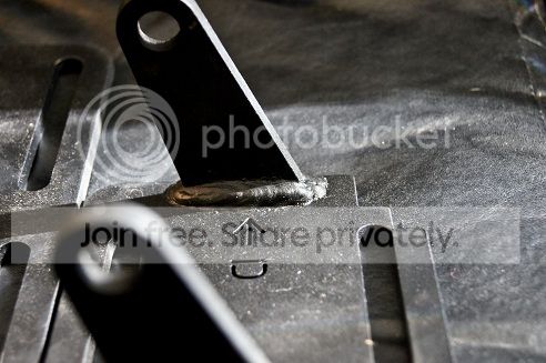

Ignore the spatter, this pic was taken before i got them cleaned up and shipped.

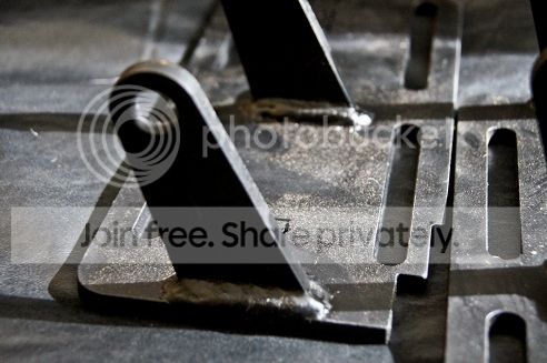

I was waiting to post my stuff to give Mr.Dingo a chance to fix this mess, but since its just more crap ill post mine. Mine arent cut on some fance water jet, just my good old cnc plasma. If anyone reading this decides that they would like a set of mine just send me a pm.
