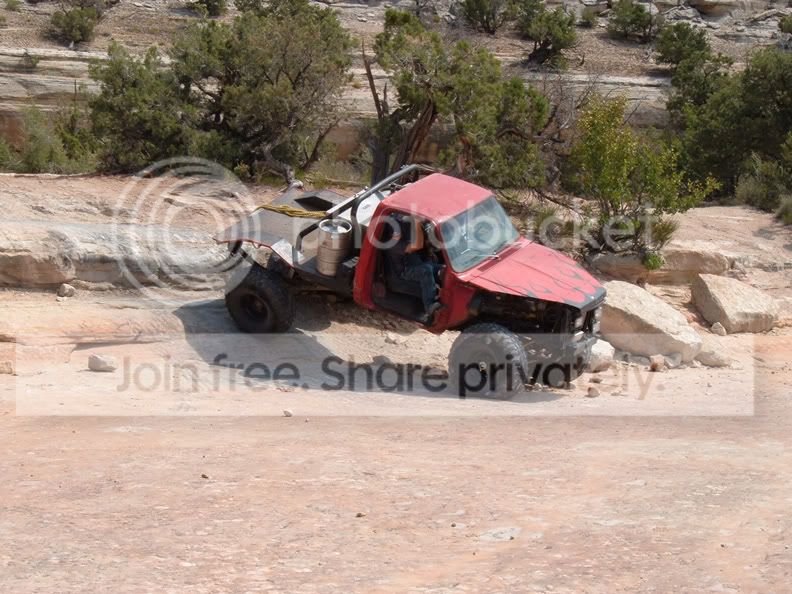

Who's truck was that? The red Chevy truck with the flatbed and two kegs for gas tanks?
I just watched a "Four Wheeler TV" I recorded on the DVR yesterday. I think it was the same truck, at Moab Jeep Safari. Rolled over on it's side, then winched back over.

When we went to shiloh ridge (pictures are on here somewhere) that was a white 4 linked Dakota on rockwells and like 60 inch tractor tires that had a keg as a fuel cell...pretty coolI thought...
Yep that was me, The funny thing is that I have been through there plenty of times without spinning a tire.This time there happened to be a camera crew there and the first thing I do is run my left fender staight into the wall:doah:

hey ivie29, got any info on how you did that??? you just running 2 kegs? you dont have fuel injection I guess?
I just drilled and tapped the kegs and installed 3/8 nipples. It is injected and all I did was T the return line back into the inlet side of the pump.A lot of diesels are plumbed this way.
