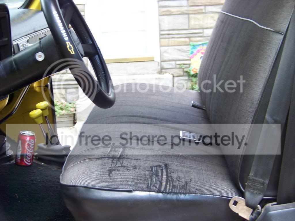

bench seat, worth it?

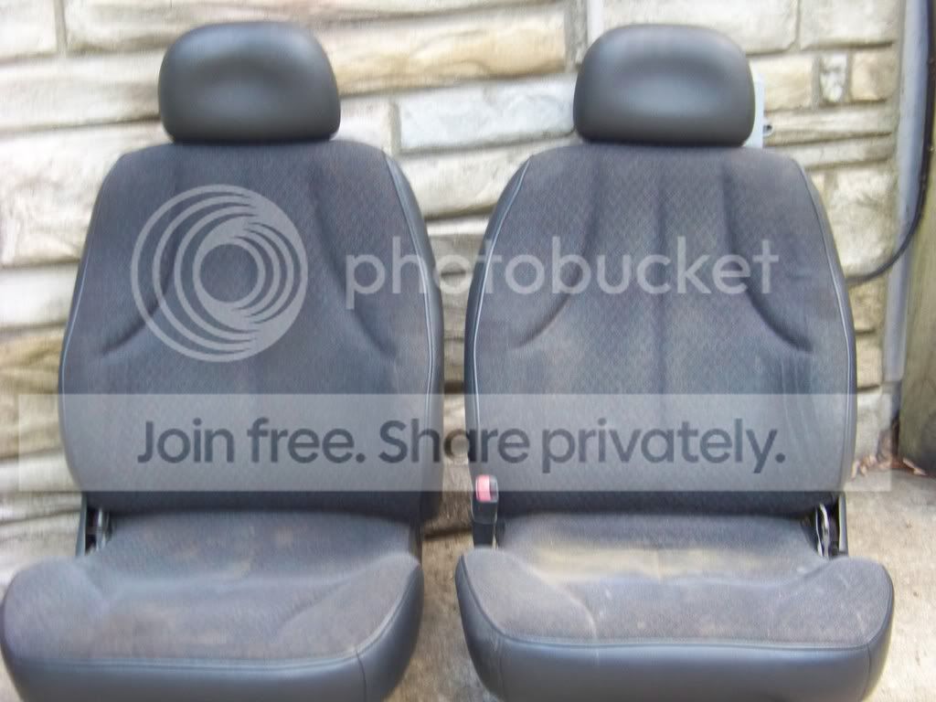

here are my seats

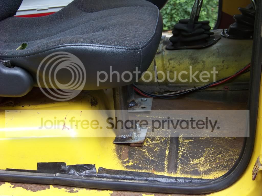

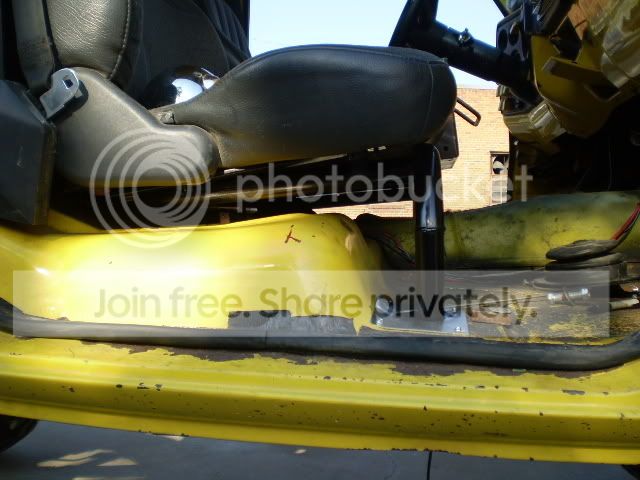

1x1 1/8 wall square tube. stock bench sliders removed from bench frame.
then 88-up truck buckets and police center console.

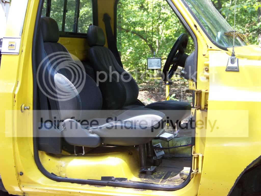

bolt down sliders like stock. then make frame and weld to sliders. find center of both seats and weld in rails. weld sliders to them. and presto full bench slider with buckets. or each bucket slides. so worst case bench and bucket full front no room for anything.
in pics you can see both bench and each bucket contol levers for full adjustments.
then mount police center console with full switch panels and other goodys in it and go.

i dont no if anyone has a 94 cavalier near you,but i have one for a beater car and i reeeeally want those seats in my truck, they arent a extremely soft pimp seat but they feel like my '89 seats but with a little more side support to hold u in.
i have cavilers in mine its in the pic i posted

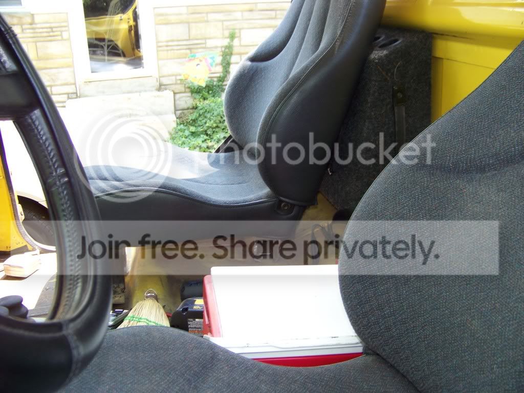

my first attempt at mounting
this is what i had and the steering wheel was aginst my crotch the whole time
i paid 24 bucks for my seats at pick and pull i dont think you can beat that...i didnt end up using the sliders cause it didnt work with my floor to well
ya, those r the '97ish cavaliers. my seats r from the square berretta looking cavaliers....these actually.
