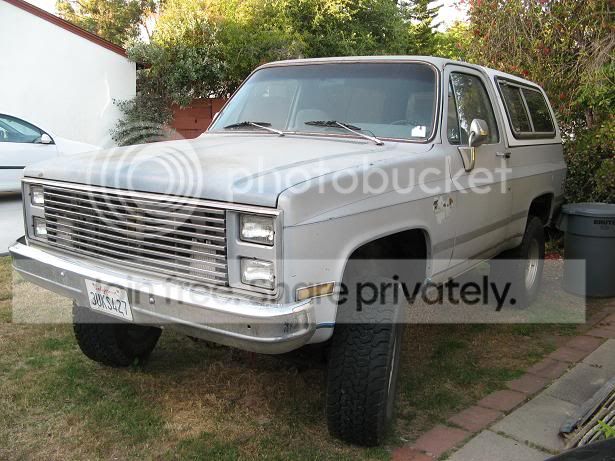

From a young age I've been into offroading. Normally as a passenger with my Dad, I've had so much fun. When I bought my first truck however, it was a new trouble free, good gas millage, lowered S10. I still have it, its my DD. I bought a quad 3 years later, '04. I still needed that 4x4 though and it had to be a K5. Finally had the money late last year to buy this.
K5 Silverado, 350, 700r4, 3/4ton D44 and 14BFF. 16" Centerlines and newish offbrand 31"s.
My first used car purchase, which comes into play later. :doah: The picture is from my first time out with it. The shell it came with had old rack holes drilled all over it. Cut it up and threw it away after no one wanted it. Picked up the white one for $100. No holes and it had sliding windows. :)
I picked it up about 300 miles away. Bringing a friend with me and lots of tools, fluids, and money, I made the drive without any trailer available. Looked it over, talked with the guy, and drove it around by myself. The PO was waiting to pick up his daughter and had time on his hands. Ended up checking the compression and replacing all the spark plugs, before I said I wanted it. 140-145 psi on all cylinders, low but even. It drove nice, no rust, no visual damage, and so I ended up getting it for 1400 bucks. A decent deal over anything local in the Los Angeles area. Only thing I hated was driving it home like this. It did have a temporary gas and temp gauge. Heating and A/C work very nice.
Got it home and started further inspection. Ripped out all the old POS wiring someone did for a stereo. POS speakers and sub box. My god, who wires things with different size wires, butt spiced together, all in one run? Going from something like 12awg at the battery, to 16awg connected under the bench seat that runs to a sub. Gezz, the 6x9's mounted in the panels were just as bad.

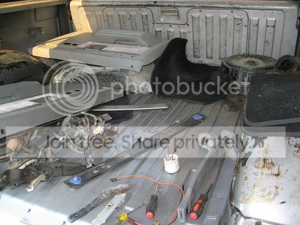

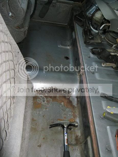

The seats are out of a late model Tahoe. Driver side is electric, but slow. No big deal. Did find out it was mounted with only 2 bolts. The passenger side is manual, mounted with 3 bolts lol. The carpet was decent, looked like it was removed from the same Tahoe, fit ok. All molding and rails were good, headliner too. All windows and locks are electric, they all work ok.
I ended up hating the headliner and sold all the molding for a good price. I didn't like the rear carpet so I ripped it out as well. At the time, I kept the front carpet. After working on it some more and needing to fix the seat mounts, I pulled the front carpet out too.

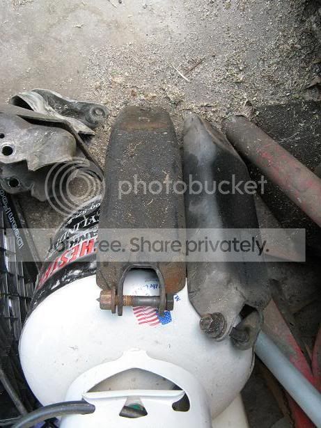

I've collected some parts while driving the truck. What I'm looking to do is a 4" lift, 1" body lift, and 1" 0 rates. I think this will keep the majority of the weight low, but still let me run 35-36" tires w/trimming. The 1" body lift is mainly there to give me room to clock the transfercase. Most of my parts are used or pre-purchased new, trying to save the funds. Got some TC HD4" front springs w/0 rate, rear 56" suburban springs, ORD 4" shackle flip, and some ORD greaseable bolts and front shackles. The front 0 rates will be moved an inch forward.
More parts in the garage than on the truck. I also picked up some D44 flat top knuckles and had the one machined. :D I learned a little bit about pressing in ball joints, so I bought a harbor freight special ball joint/ u joint press. I'm hoping that was the hard part, but I've read torquing them is the funnest. O, and I'm learning how much it sucks to buy parts and change your mind. Anyone need a new fan clutch or swag bar bushings?:doah:

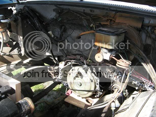

Seems the engine just wasn't happy with it's new owner, or PO I"m sure. It stopped getting hot, but there were other things going on. If I drove it far (40+ miles) it would start spitting coolant back through the reservoir bottle. The hoses were also under a lot of pressure, days later I could open the radiator cap and have pressure escape. O crap. I knew something wasn't right long ago, but never really cared enough to stop driving it :D It was fun and an absolute PLEASURE to drive.
Well, it was a blown head gasket or something. So I tore into everything and realized " this thing has been apart and thrown together before". There were miss-matched bolts everywhere. I thought maybe the passenger side manifold was cracked (seems popular) but no....the bolts holding it on where too long and where bottoming out before getting tight enough. Ugg. Couple different ones on the intake manifold too. From this point on, I knew I'm in for a new motor.
Fast forward> pulled the heads off and found a puddle of coolant in #7 cylinder. Figured as much since that spark plug was a different color and smelled like....coolant! :mad: The motor is a 30 over 2 bolt 207 block and currently in the recycle pile. The connecting rod nuts where all the same except 3, they were I think 14mm lol. Of course the piston with 2 shots of coolant on top of it was a mess, top ring was broken in a few pieces.

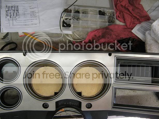

This next week is a big test at school for me, week after that is my finals. Progress will cease for a little bit. I have been working on installing my gauges though and am quite happy with the way it's turning out. I hope the way I'm doing it helps other people with their own. I've taken ideas from various places, starting with Chevy305's build, and moving from there.

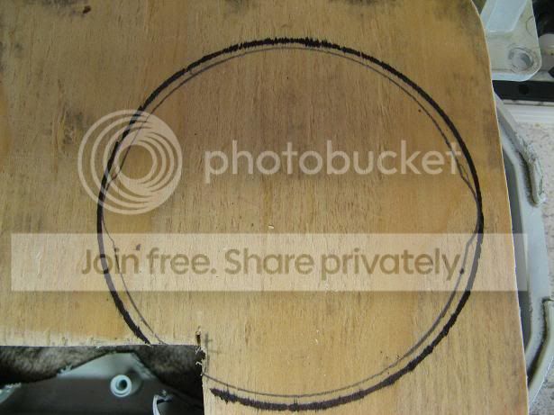

cutting the old gauge holder, Edward Scissorhands style. Getting things out of the smaller gauges way. With the larger gauges I was looking for a flat surface to mount a panel to, so I cut things accordingly to use the 4 screw holes in the corners.
After the fact, I realized the hole for the light, just behind the shift indicator, was prolly something I could have kept. No I'll just throw a small LED behind it somewhere.

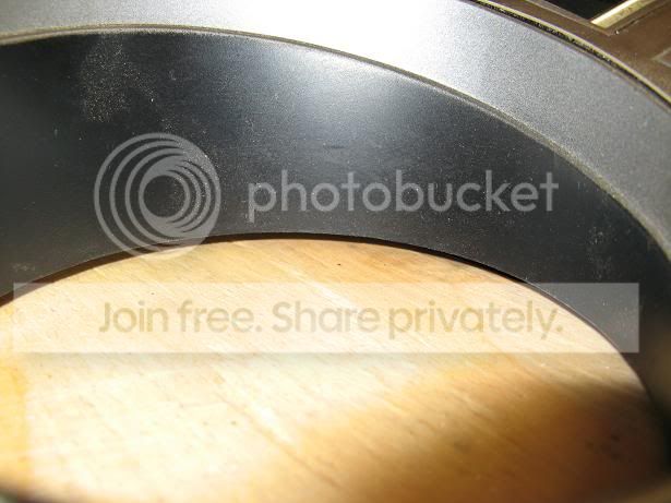

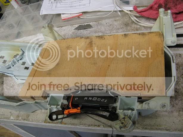

I had some 3/4 plywood and starting shaping what I would need to mount some gauges. On top of the plywood I was going to use some 1/8 aluminum. This was going to play two roles. I could mount the gauges to it securely. AND it was the perfect thickness to put the gauges right up against the old bezel rings.
I cut a piece off the old clear plastic to cover the shift indicator, stock like. Afterwords, I realized I didn't need the extra amount at the top of it, where it necks in or squares off. It has just gotten in the way now. However, it might play a role later in lighting the indicator.
