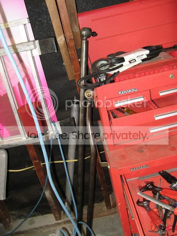

shoot, I got a crossmember, crossover draglink/ pitman, HD tierod, 0-rates, bushings, steering box brace, 1" body lift, and brakelines from ORD coming. From DIY: rear shackles, spring perches f/r, clocking ring, 14b diff cover, pinon guard, and inboard rear shock mounts. From EBay: EZ Wiring 21 kit, D44 diff guard, and new dome light w/ switches off a F**d Victoria I think. From Summit: Edelbrock headers, MSD Dist, and one light socket for my fuel gauge.

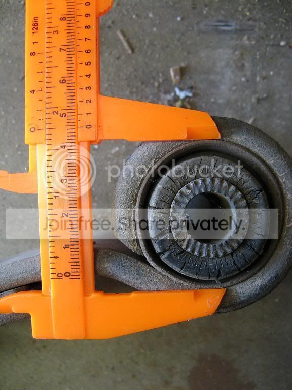

Also, I got some bushings for my rear leafs. I talked to Steve @ORD about mine. I seem to have 1.75 eyes, front and back. Need to talk to him again, half the bushings we ended up ordering are too small. This is what I have. Am I right? Also, do I remove the outter most sleeve, leaving just the leaf left? When I put the new poly ones in, there's no sleeve between the bushing and leaf eye?

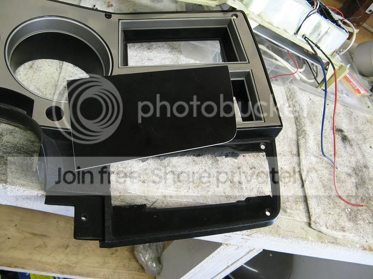

The PO cut the stereo hole and the metal dash behind it. Sucks, so I used the area for my last two gauges. The stereo will go in a Tuffy center console.
I still need some SS screws and a few nice looking rivets to finish off the dash panels. Then it will be ready for the truck after wiring is done. While I was pulling wires out and saving the AC and dome stuff......I came across this things someone must have snuck into my truck. :confused: O well, in the pile of crap it goes. :haha:

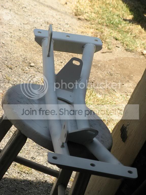

Crossmember is OUT!! I've got 4 rivets under my belt now lol
Air chiseled them SOBs out.:D
can't wait to do the rear shackle flip rivets. :doah:
currently working on putting ORD piece in, need to drill holes

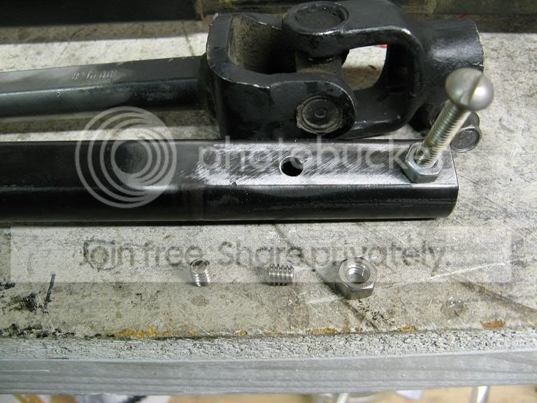

well, no one might be interested in my build, but I'll keep the updates going. I tingle with updates, no mater how far apart lol. I worked on getting my cherokee shafts ready for the truck. I bought two at the junkyard, and one on ebay for much more money :doah:, a plan B I didn't need.
Here are some direct pictures of the two shafts I have.
One used 7/16 bolts and the other used 13mm. The pivot joints are slightly different on each, but the splines and "D" shape measure out the same with my calipers.
I heated each one and pulled them apart. Neither shaft had any rubber inside, only rust and the plastic "spacers" or sleeves. They didn't have any plastic or rubber pins visible from the outside.
Here is one pulled apart and ready to be welded. The other behind it.
Here are the plastic spacers or sleeves some people have been finding. Don't throw them out. Even though I'm welding nuts on and using set screws doesn't mean I wouldn't mind the plastic taking up some slack.
I snagged some SS set screws from work. I had some nuts in the garage that work :) I drilled a 1/4 hole, filed out the inside, and wire brushed the outside so it's ready for welding. The long bolt is there to get everything straight while welding. It fits tight.
Here are the two ends. The part numbers on each shaft are different. However, the splines and "D" shape are both the same size.
The shaft with the 13mm bolts, or the shaft that's not pulled apart and dirty, has a slightly shorter male end. The spacers are in different locations too, but it really doesn't affect the use of the shaft for our trucks.

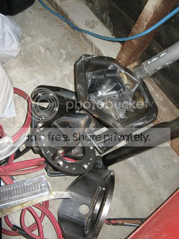

Got some more parts in today. DIY4X delivery
clocking ring
14b cover
pinon guard
spring plates for 14b and D44
lower shock mounts for 14b
rear shackle for my 56" leafs and ORD flip, 6" length
need to get this motor and wiring done damnit, the parts are READY!!:woot:
Nice build so far. So you're going to put a bolt through the hole in the steering shaft? I'm not sure if that's a good idea. Maybe I'm not seeing exactly what you're doing, but that shaft has to be able to collapse in the event of a collision so it won't break through the firewall and impale the driver. I put the same shaft on my truck and I didn't worry about putting anything to try to hold the two pieces together. They won't come apart.
I'll be watching this build to see all your progress. Good luck!
