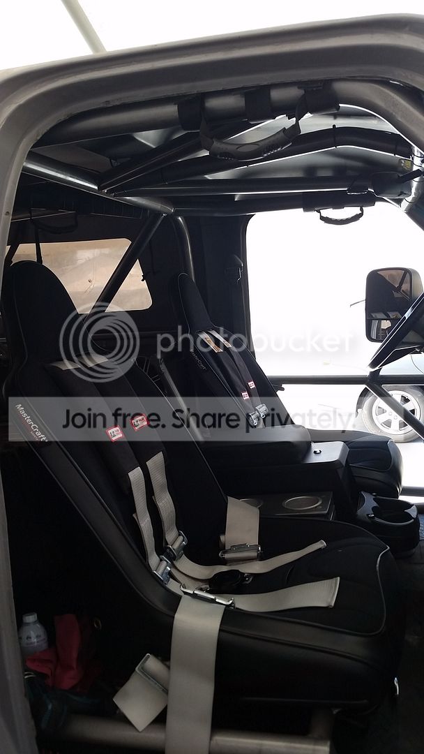

Anybody have experience with the "cam-lock" style harnesses? My rear belts are latch style and that's all I've ever used. But that is for the rear passengers, you don't need to jump in and out. I'm curious if the cam-lock is safe, comfortable, and easy to use
Ive used both, honestly they are both comfortable.
I personally think the latch style is easier to use.
Honestly, I always considered those kind of a joke. Like the stuff little ricers use lol. Glad to here they're a viable option
I like them and feel very safe in them.
Crotch belts are annoying anyways and you would need to be doing alot of really high speed stuff to ever submarine out of your harness without one imo.
Not being a turd or anything, but if I had to pay for new harness, it would spec SFI 16.1
They are a little more expensive. But I've seen guys walk away from 150+ MPH roll overs. That's worth a few bucks
Do you know any drag racer, circle track or dirt guys? Ask for their old belts
no no, I wasn't even considering a crotch belt, not needed
and I might be able to get some old belts out of a Baja 1000 truck, whatever truck class is just under Trophy prolly. I guess they have to change them every year or whatever, so he's got pretty fresh belts left over.

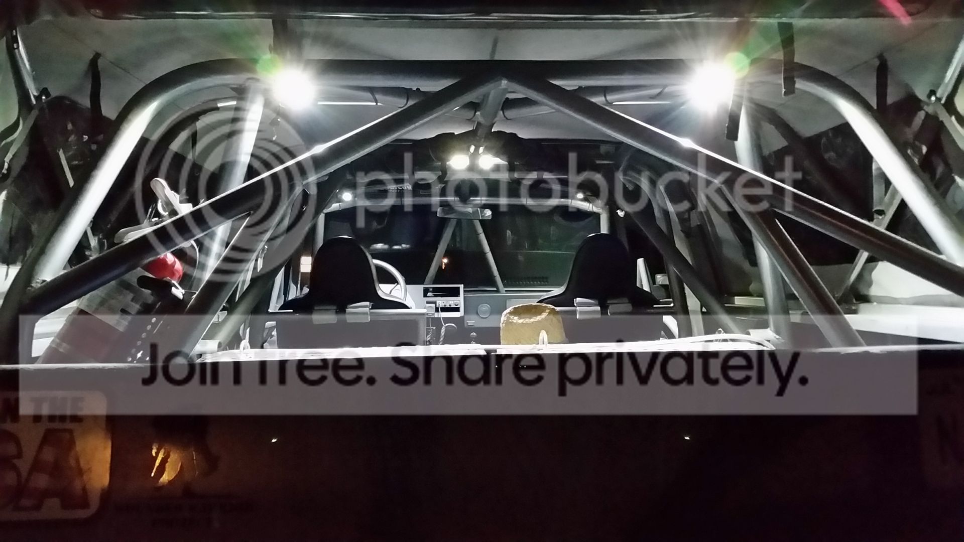

1) I wish I had wired the truck like this the first time, some 6 years ago. One panel constant, one keyed on. Easy

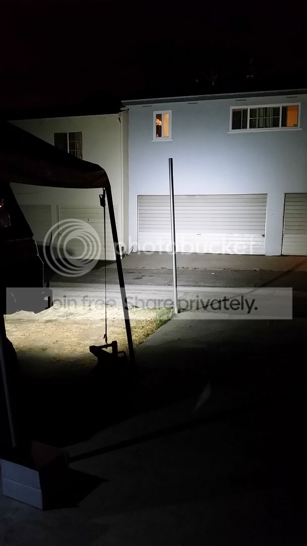

Reverse bulbs blew years ago, not messing with it, ripped out all the wires
Now I've got 3x3 LED pods flush mounted in the bumper with a switch in the dash.

I have zero pictures or video from BB16 :( The truck did great though. I got up stuff I either didn't last year or didn't attempt. Body damage is light but it did tweak my driver door some. Just need to adjust the hinges to compensate. I've got some cage noise from it rubbing on stuff. I plan to plate in around the floor, firewall, windshield, and roof. This should give me a more rigid body, since I'm already solid mount from the B hoop back. Other than that I now have ZERO oilcan sounds when all twisted up. I love the cage, seats, and belts. Also loving the new electrical changes, dome and reverse lights :D
