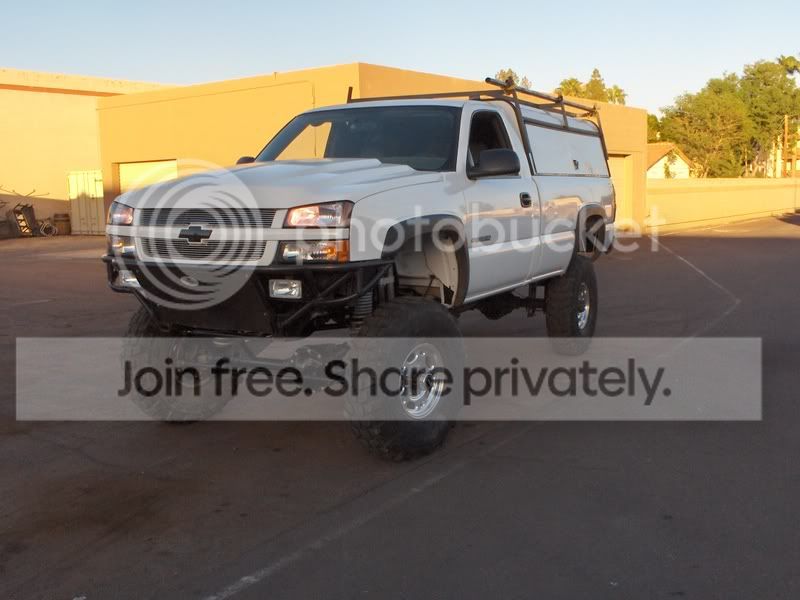

most of the benefits have already been mentioned... such as stronger gearsets, better driveshaft angles, and overall added clearance under the yoke. they also have dual piston calipers. not real sure how much better they stop compared to chevy large single piston calipers though, so take it for what its worth... the biggest reason most ppl want these axles over a chevy 60 is the vast quantity of late model truck owners such as myself that want to SAS their trucks, and after the demise of the "73-87" chevys and the >93' dodges all manufacturers switched to driver side drop differentials obviously making the ford axles more appealing for such swaps as it allows said person to keep their stock transfer case (excluding np246s) i however took the much more involved route and went with a chevy axle, but we wont get into that
