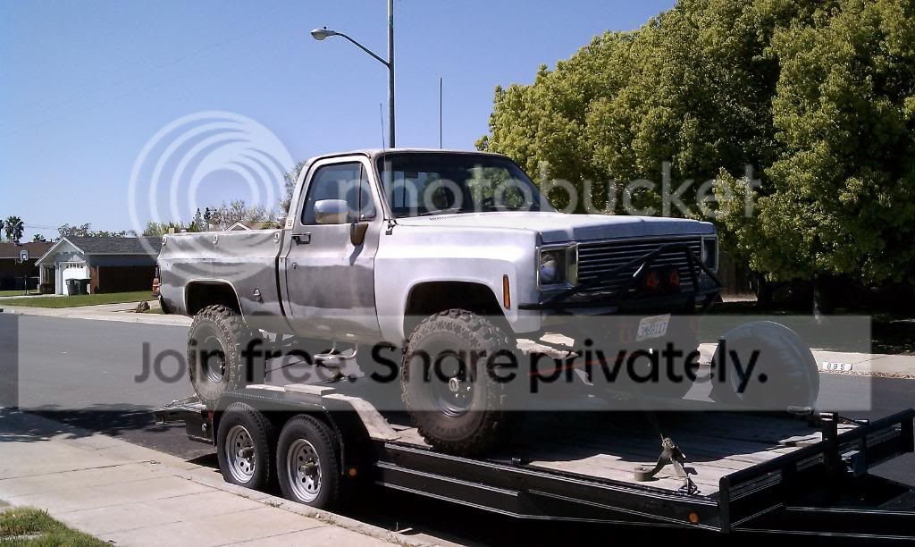

Due to much ball busting,Im gonna go ahead and start a thread on this thing :D
When Cheryle took a turn for the worse her truck was offered up for sale to her extended family on our club board. I was interested but I didnt feel right about even looking at it because she was still alive. But I was assured by Dan (Gokartergo) and Cheryles dad that she would be happy if I had it. So I agreed to take it a few days before she passed.
For sure not the direction she was headed,but Im going to put my spin on what she started :D
I spend some time in the desert racing from time to time and have always been a fan of vintage class 4 and 8 trucks. So thats the direction this is headed,a wannabe prerunner/class 4 truck :tongue1:

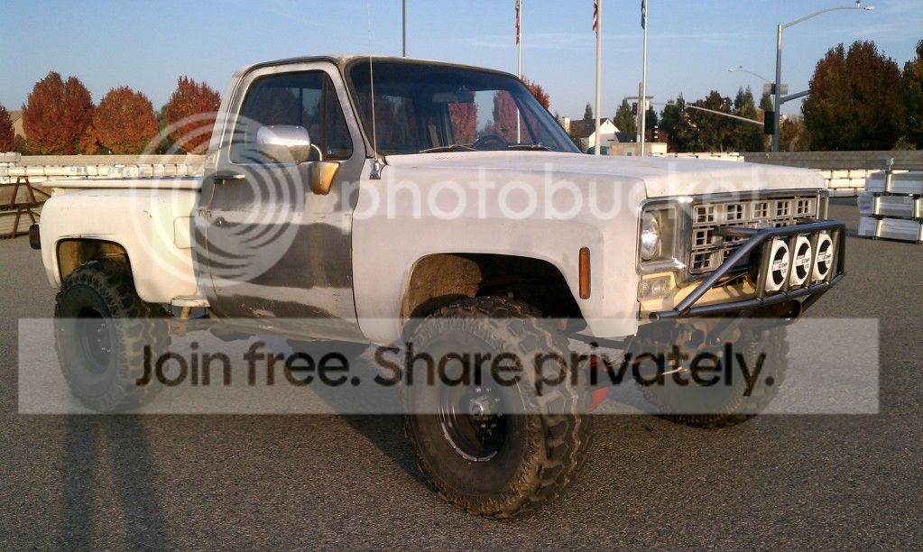

Its been slow going but its far enough along for me to start a build thread I guess.
Its a 77 K10,GM crate 350/350/203,Dana 44/14 bolt both open with 4.10s,4" Tuff Country front and rear springs,37-12.5-15 SSRs.
When I brought it home.It ran out of gas putting it on the trailer and I had to borrow some gas from Cheryles neighbor :haha:

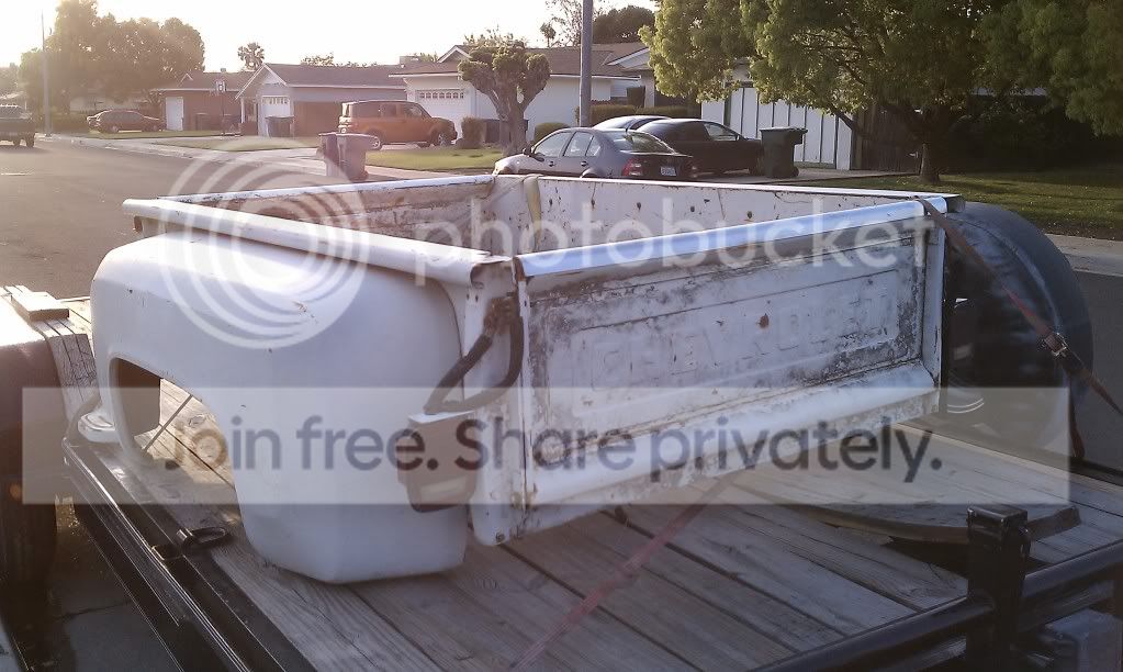

Picked up a stepside bed for it . Because everyone knows,stepsides are faster in the desert :whistle:

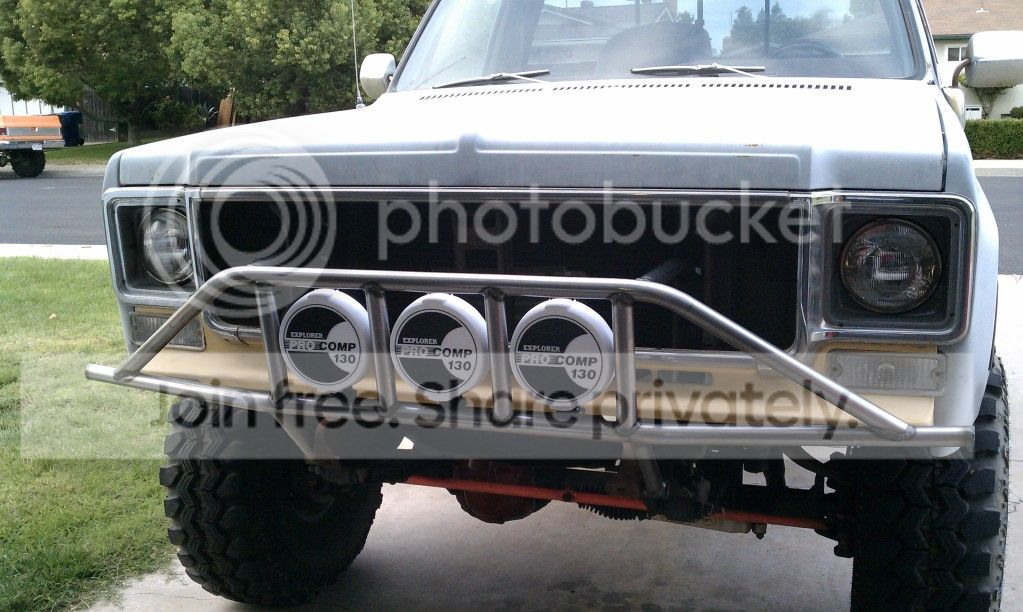

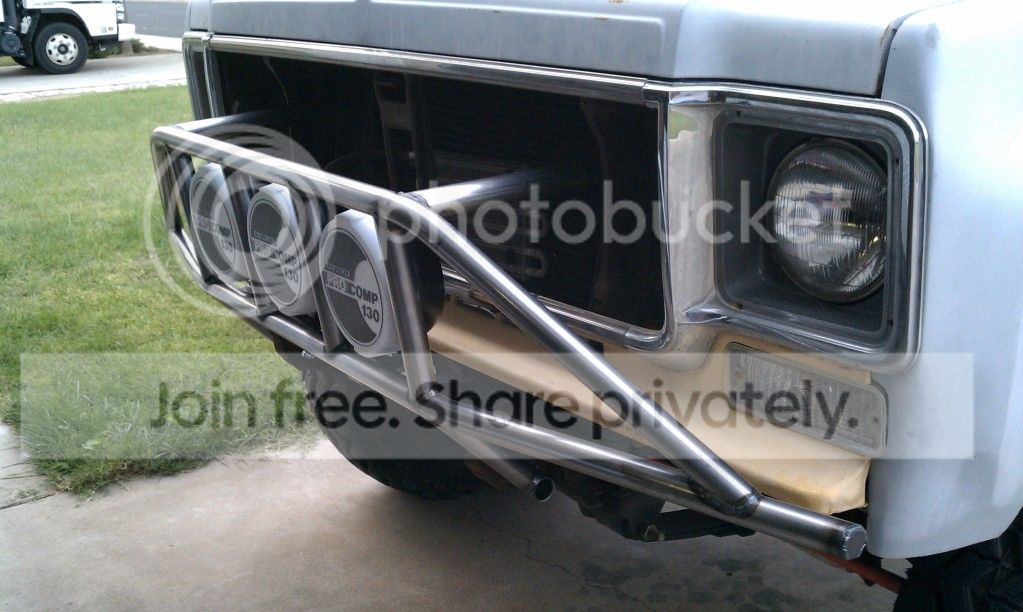

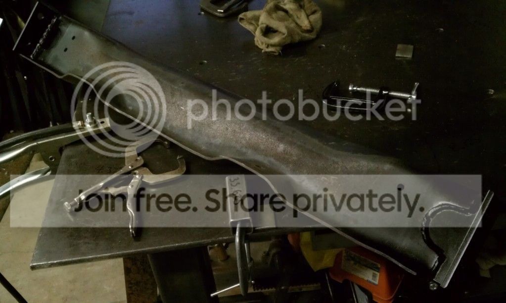

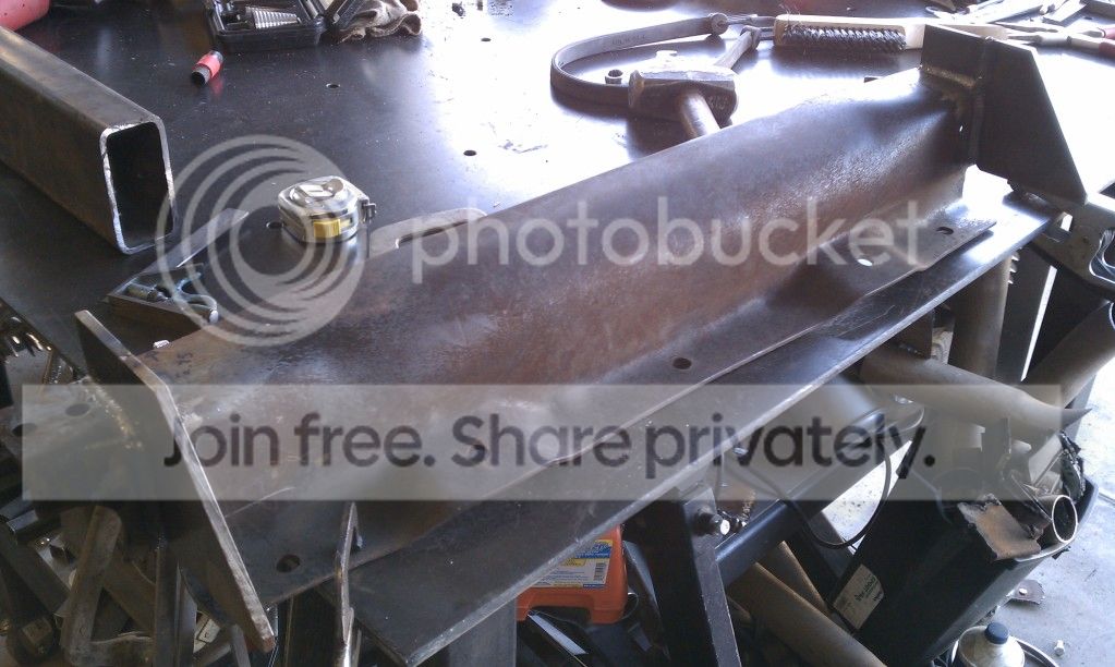

Just to give you an idea how slow this project has been moving at times,start to finish this bumper took about 5 months to git done :doah:
Pulled a lift leaf,a load leaf,and installed 2"drop shackles in an attempt to get it level and improve the ride.Got rid of the tube grill and found a correct one to cut up and throw on.

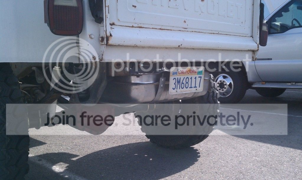

I wanted to ditch the saddle tanks and run a 32 gallon Blazer tank.And I wanted to mount it with the two rear Blazer crossmembers. My friend Chevysmithz71 knew where there was a Blazer upside down in a ravine on private property.He got permission to go down and cut the frame off just in front of the fuel tank and hauled it out for me :thumb:

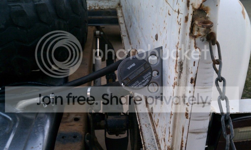

I made the rear one bolt in,the front one is welded in.

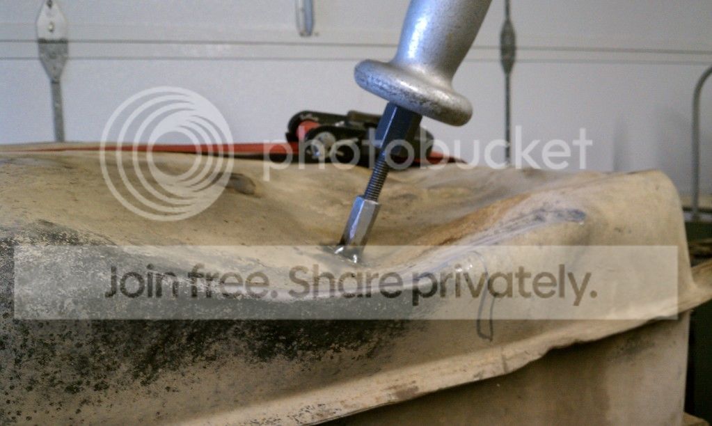

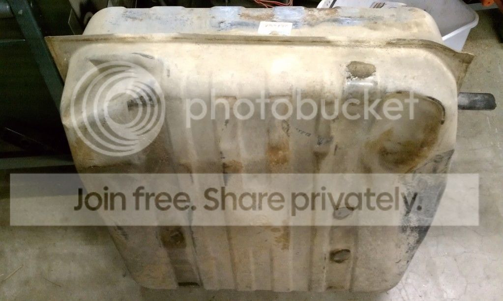

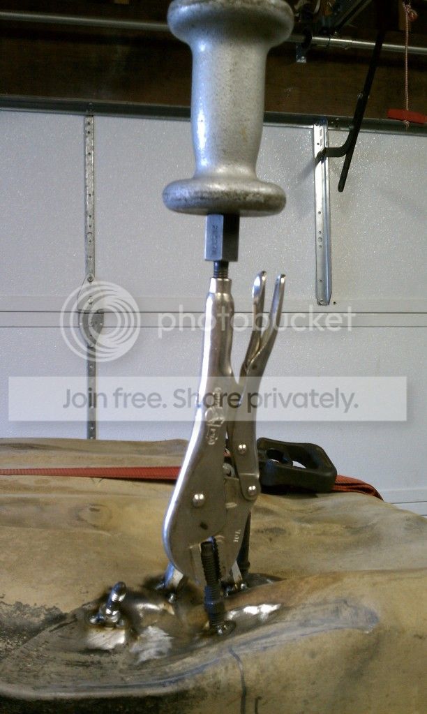

I picked up a used tank and while smoking some crack I thought maybe I could straighten it out enough to use.
Well the crack wore off and I just bought a new tank :haha:

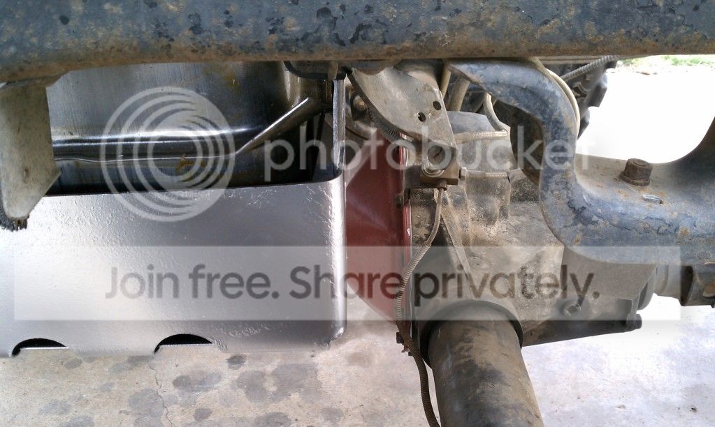

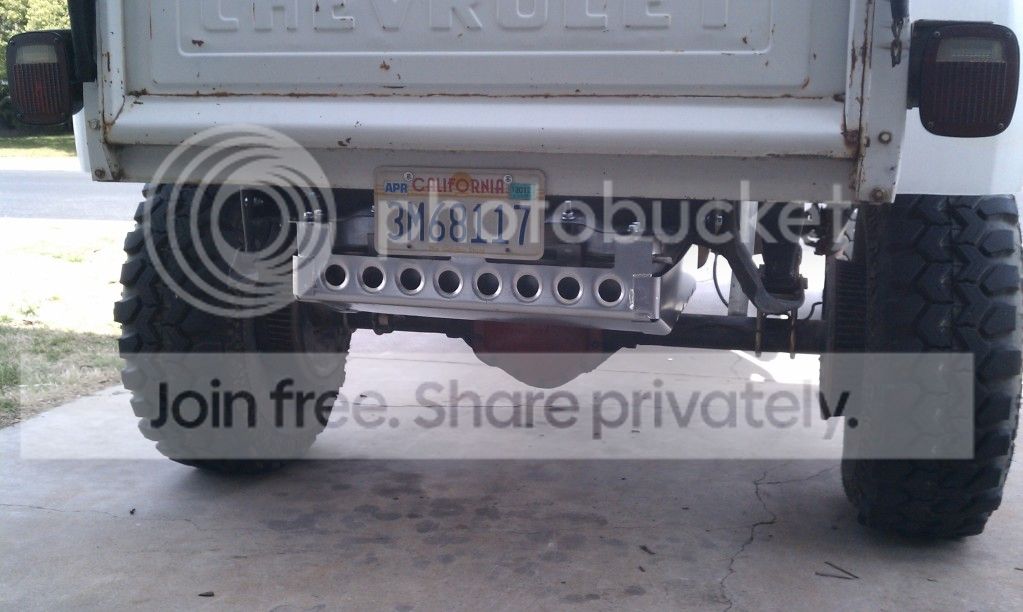

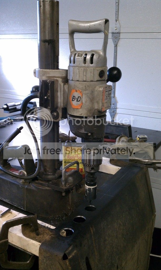

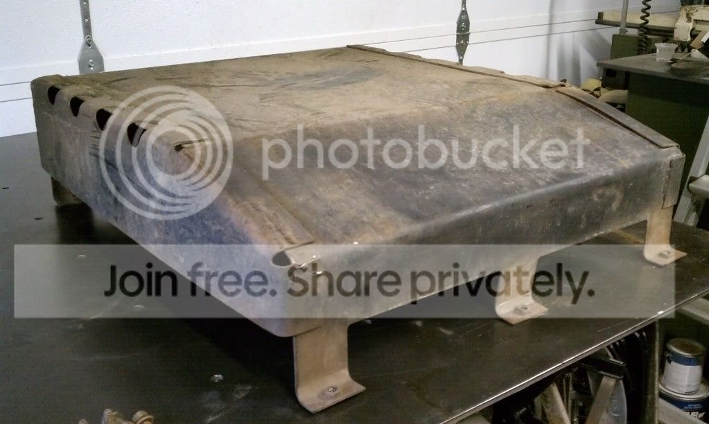

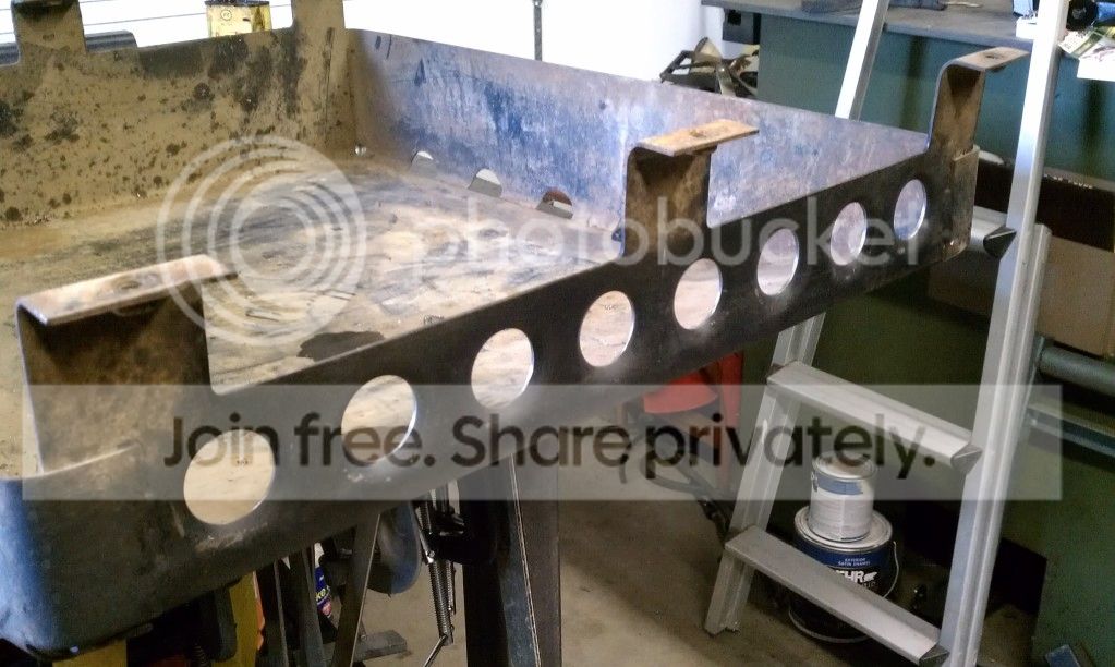

Chevysmithz71 gave me this sweet fuel tank skid that came on a project he had.
Straightened it out a little and added some HP/Speed with some dimples :pimp:

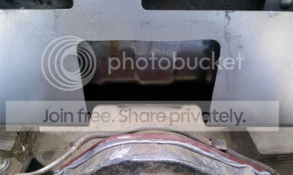

I ended up having to clearance it a little to clear the 14 bolt.
Good to see the truck back in action! Skid plate looks cool from the back!

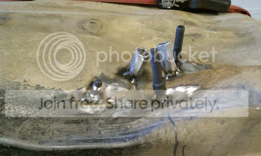

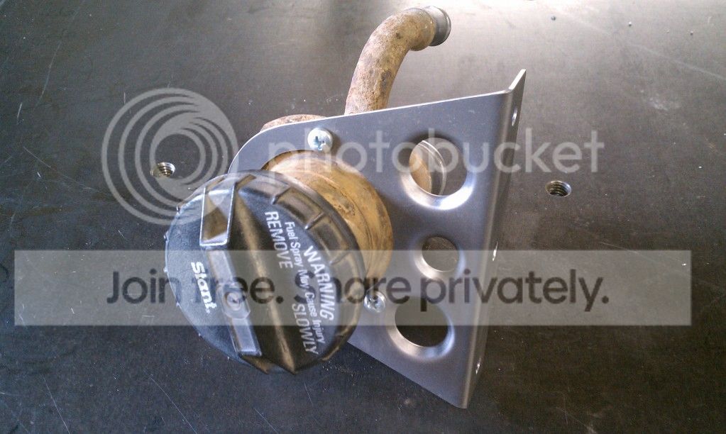

Made a fuel filler bracket and reused one of the fillers off the fleet side bed :pimp:
More HP/speed with some dimples :haha:

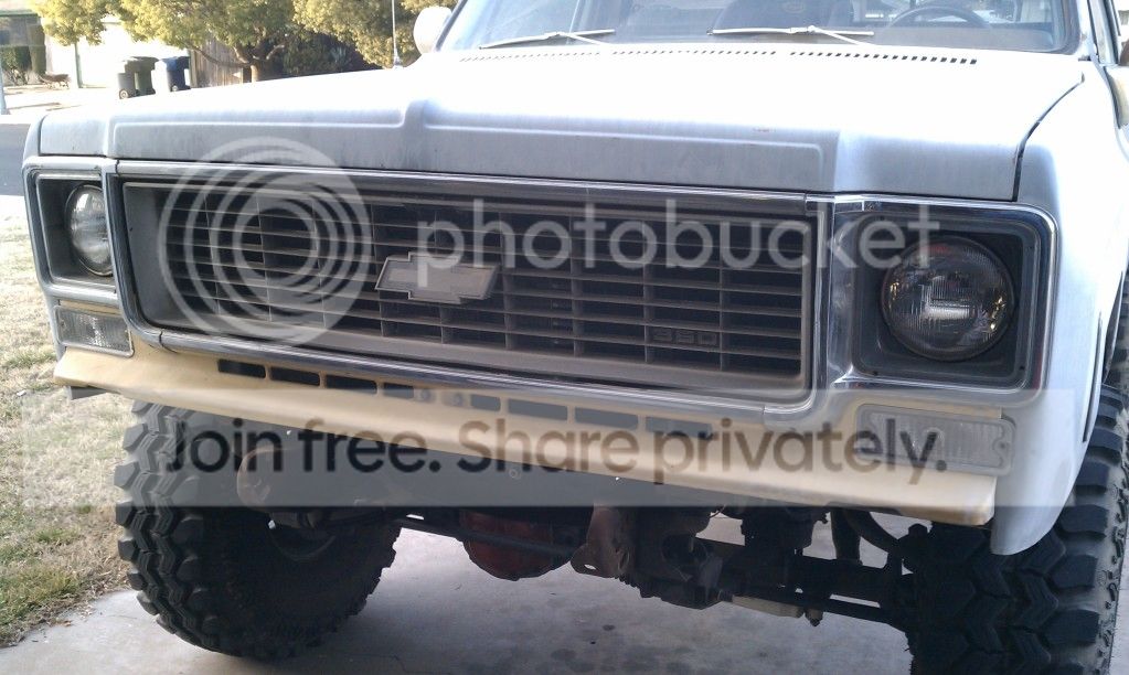

One of the little things I have done.I got the earlier sheet metal brackets for the core support so I could run the grill off my old 74. It still has Moab mud on it from BB06 :D
