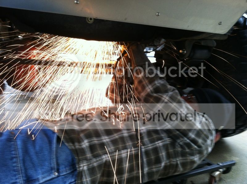

I put the boy to work on a rainy day project yesterday. Got the ORD crossmember installed and 2wd box on the frame. I gotta cut down the drag link and weld in the inserts and it will be good to go.
We drove by last night going to a Christmas dinner and I looked down your street but didn't see anything. Figured you gave up because of the rain, glad to see ya' put him to work. :)
How'd the ORD crossmember go in? I'm afraid I might have to go that route someday due to clearance issues.
Yea.Gave up about 3:30.
I had the factory one out in about 10 minutes and it took Michael about 3 hours to get the new one in :haha: He probably could have made it to church with you guys yesterday but he didnt get up til 11 to help finish up :whistle:
The install is easy and pretty straight forward. And you will need a 90deg. drill to drill the holes in the frame.
I need a straight drag link. The one I have is a standard one for a 4ish" lift. I rotated it flat so as not to put the drag link ends at funny angles so we can run it for now.
At the right angle it looks like there is no steering :D
