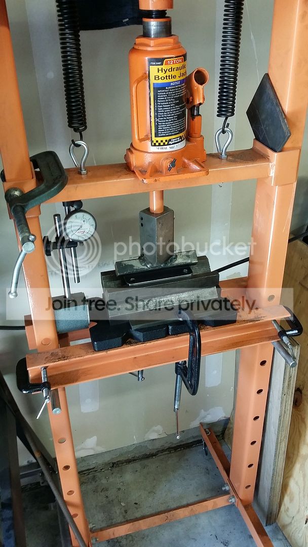

How do you make an easily repeatable setup on your janky 12 ton Harbor Freight press to make multiple identicalish parts?
1. Take as much of the slop out of the top as you can.
2. Clamp the table to the frame.
3. Capture a chunk of eBay 3 way bottom die to the table.
4. Use a dial indicator to determine top die height for desired angle.
5. Press to the same number on the indicator for the bend.

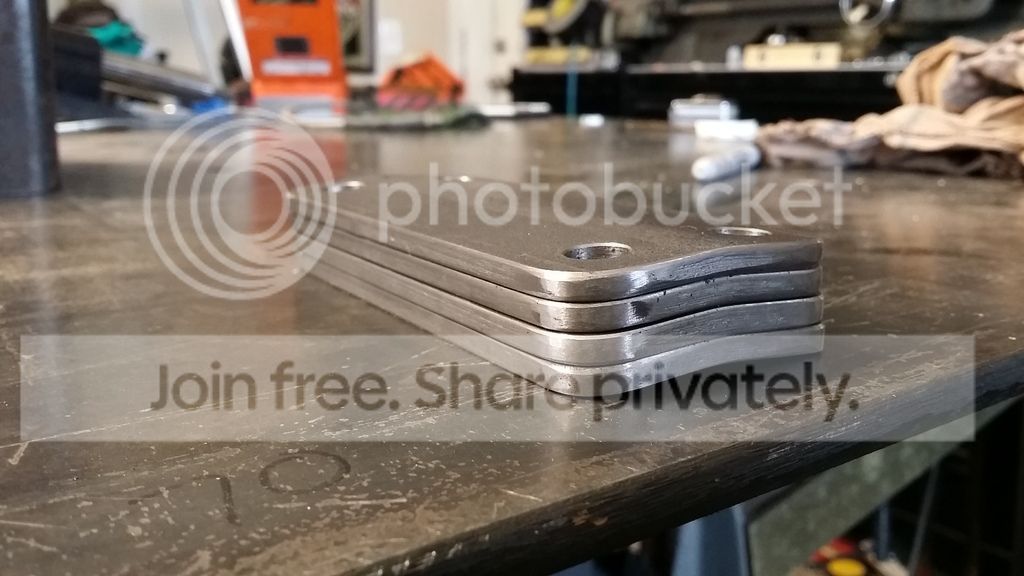

Two pairs of identicalish dohickies.
The angles on those tabs match the shape of top of the cab across the pinch weld.
Rather than buy billet mockup bushings, I made these.
Pull it all off and make an "X" with the help of string, hard drive magnets, and a protractor.
Effin slick. Dohickies and mockup bushings FTW!!!
I like the bending setup, could you actually bend a 90* with that block?
I assume the other two dohickies are going on the inside of the cab?
