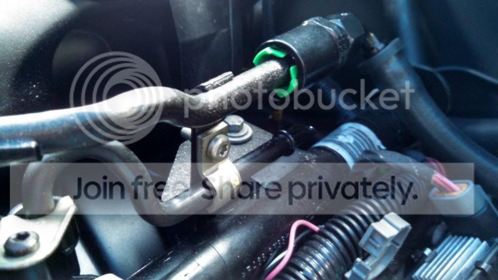

Got going on the fuel system. Pinched the return at the fuel rail flat and welded it closed. And I got the supply line run from the motor back to the fuel filter :woot:
