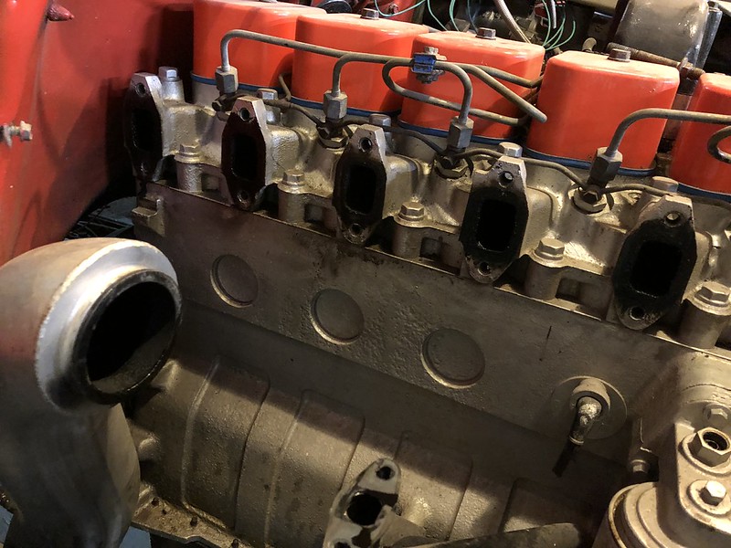

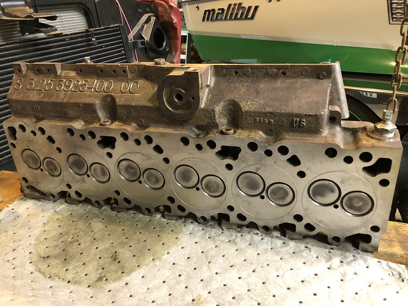

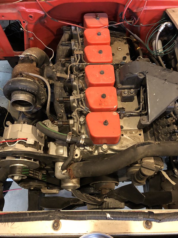

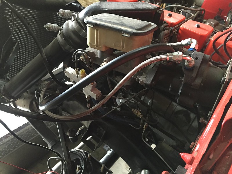

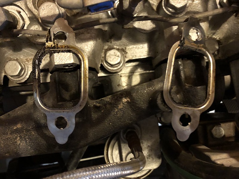

Picture for reference before I started disassembly:

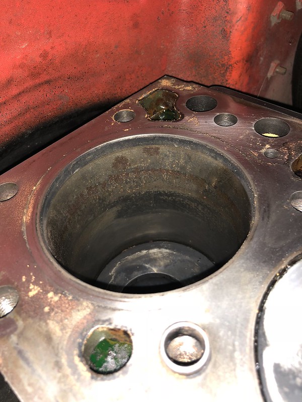

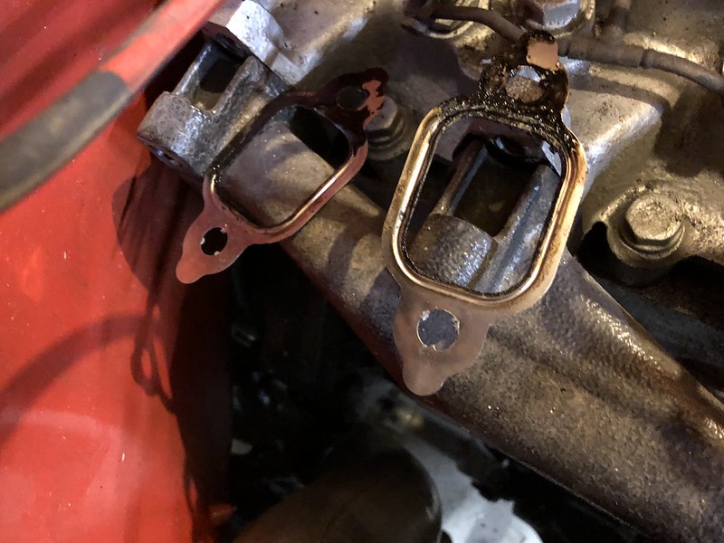

The oil wasnt present in all of the cylinders. It was worse in the rear two I believe.
These are the front two cylinders. For some reason I didnt get a pic of the middle two cylinders.
You can see the oil at the bottoms of the exhaust ports along with the oil at the bottom of the downpipe flange.

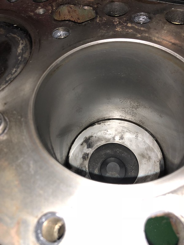

I got the head removed and took it to our local diesel performance shop. I had them O-ring the head and add heavy valve springs as well. They said that the head was in good shape and that the valve seals were good as well. I also had them pop test the injectors and they said that they were in good shape too.

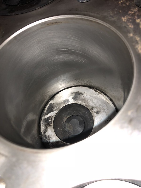

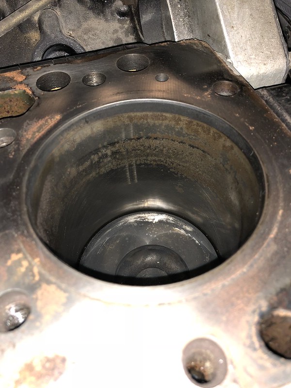

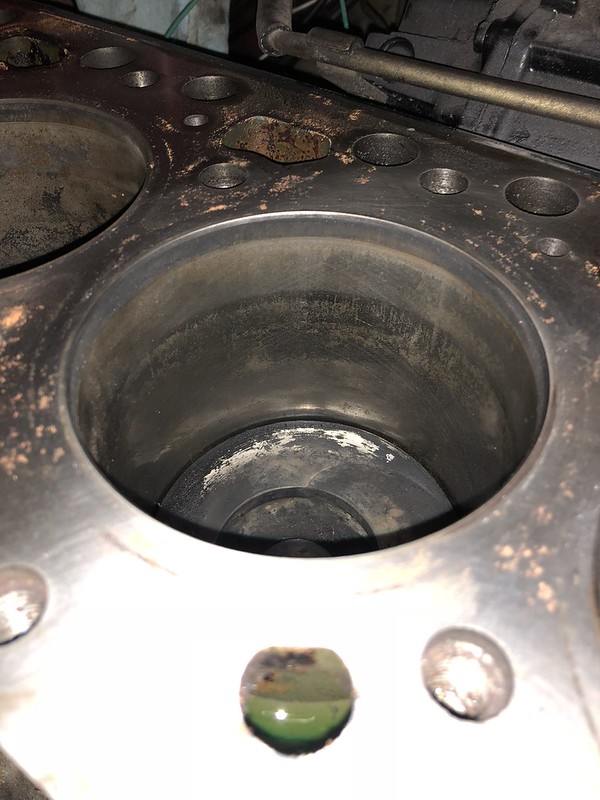

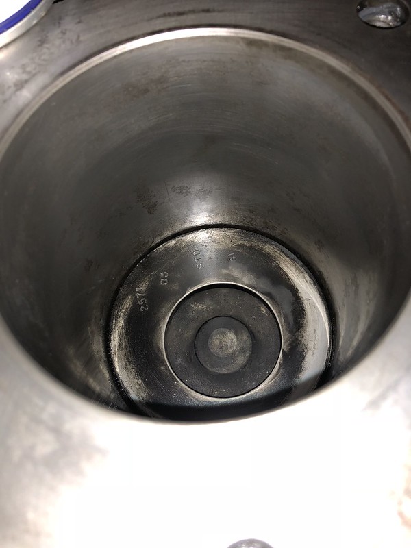

They cylinder walls didnt look too great as it looks like they all had some surface flash rust on them from the amount of sitting that this thing did. I am really not positive what the proper procedure is for this or how it will affect performance and efficiency down the road, but my hope is that it will be ok for a while.
