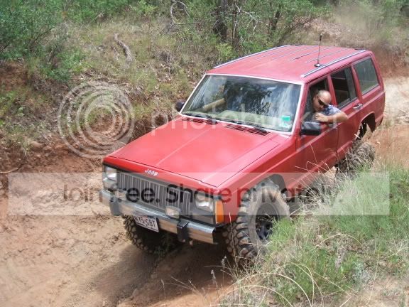

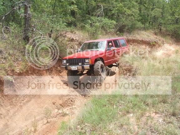

here's a couple of my xj cherokee's
HP dana 30/8.8 with 4.56's, rear welded; rusty's 4.5 inch coils and 1.75 inch spacer up front with RE 4.5 inch packs and 1.5 shackle; rusty's short arms and track bar sitting on 34" LTB's and 15x8 767's
Pair of D44 front (80's Waggy front & XJ D44) and rear with 4.56, lockrite front, mini-spool rear trussed, relocated shock mounts.
Custom Longarms, Highsteer, DOM steering with heims joints, 4.5" RE ZJ coils, SYE, RE 4.5" 1462 springs with drop shackles and sitting on 36" TSL on 15x10 6X5.5 bolt wheels.
