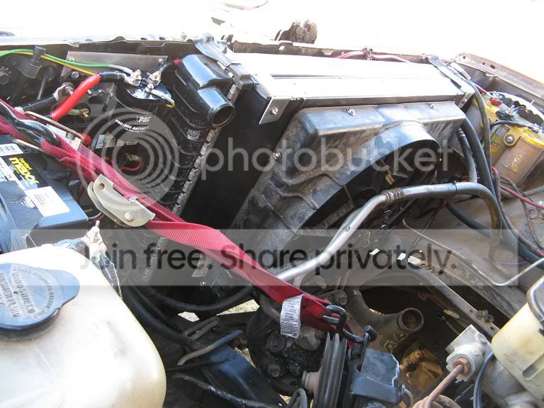

well, each battery is on the sides of the picture and when I say isolator, I mean that thing next to the radiator on the left. So they are only connected by the positive in series (sp lol).
basically you are doing what i was going to.. connect them through a relay.... i have a stinger 200A that i was going to use...

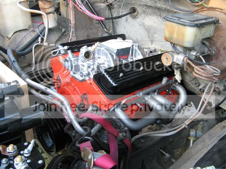

hey dont know if anyone told you .......
but you are missing.....
a motor!!!!!!!!
optical illusion, its there:eek1::D. Anyway, its good to know I can run whatever batteries happen to be on sale :)
