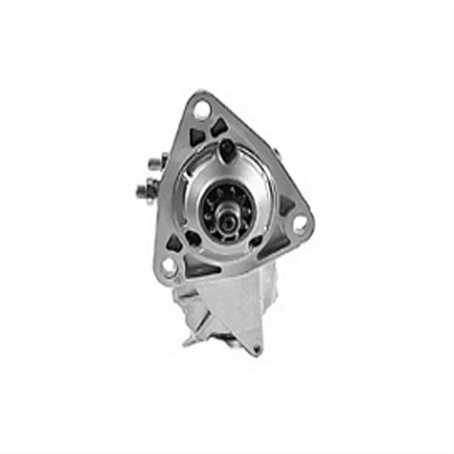

Price on the Denso is a little spendy. Looks like a nice piece though.
https://www.amazon.com/Denso-281-8002-New-Starter-Motor/dp/B008B675YY
I think I might have the same issue with the Tilton. Too close to the header. Pricey as well.

Price on the Denso looks spendy

I saw that price on summit too but thought maybe I got the wrong one since the pictures were wrong. 194 is not bad.
https://static.summitracing.com/global/images/prod/xlarge/dnp-281-8002_xl.jpg
