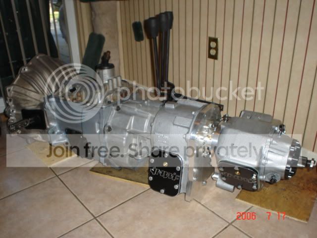

100.78:1 crawl ratio, 32 spline throughout, triple stick, 1410 yokes, smooth shifting with a .73:1 OD.
I put a whopping 500 miles on this combo, never wheeled it, then parted out the K5. :doah:
Had the good sense to keep this stuff though. ;)
It is heavy, and quite long though. If I was still building a K5 I'd go Stak, or Atlas to be honest. This will do fine in my Crew Cab though...

how much longer do you think that is than a 700r4/208. the 208 slip yoke adds like 9 or 10 completely unneeded inches i would imagine the lengths would be pretty close
almost a foot longer I replced that same combo. I got zero miles on mine before I pulled it back out and sold the truck lol

That combo is 48" from the face of the bellhousing to the center of the rear U-joint cups...

I'll go out on a limb and say I think the best combo would be a NWF Blackbox/Klune-V and fixed yoke 205. Shorter and lighter than a 203/205 with a lower low/low and four different selectable ratios and cheaper than a 4sp Atlas or Stak.
I'd give all four pinkies for a NV4500/Klune-V/205. :D
For the best all around stock t-case, I'd say a 241 with SYE (which makes it not stock :doah: )
its better but its totally not worth the money when you can somewhat get the same all around thing for half the price if you go doubler
all said and done my doublers ran me about 1800 . would have been more if I would have had to buy the cases and trans . for another 1000 I could have had less weight , better floorpan clearance, less crossmember issues, longer driveshaft in rear, simpler shift setups, and more "clocking options"
