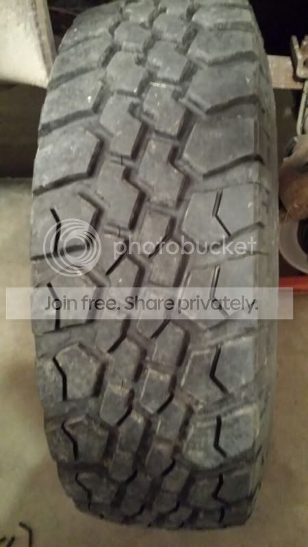

Mine seem to have very good grip aired down to 10 psi front, 6 psi rear. Hangs with the slightly bigger tire guys pretty well. I have a 6.2 thus the extra air in the front. I did groove mine like Trailworthy Fab does. See pic in the process of grooving.
On the street they are surprisingly quiet. I drive my truck 2 1/2 hours each way to the wheeling spot at 65 with no issues. I have about 2,500 airsoft BB's in each wheel for balancing. Seems to work well.
