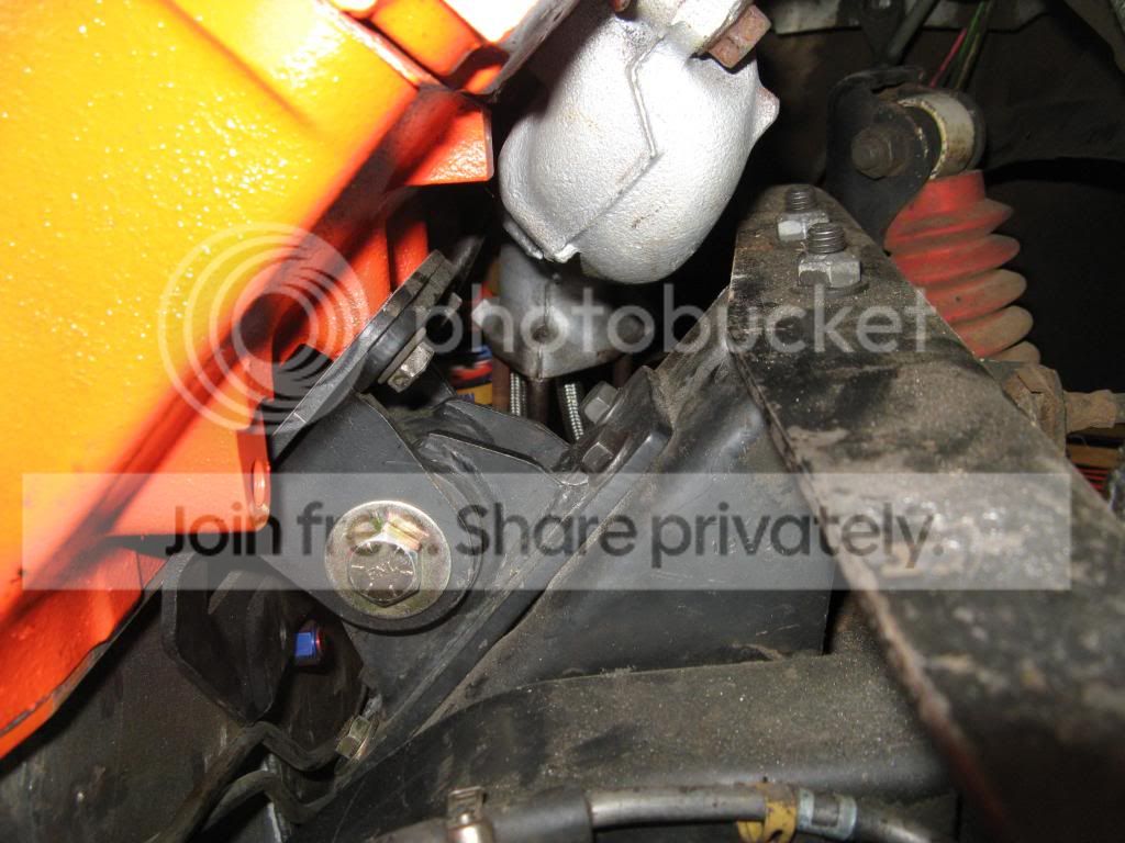

Here are some pics of my BBC mounts
With the poly the motor lifted up where it should be
Poly mounts look a lot better for sure!
