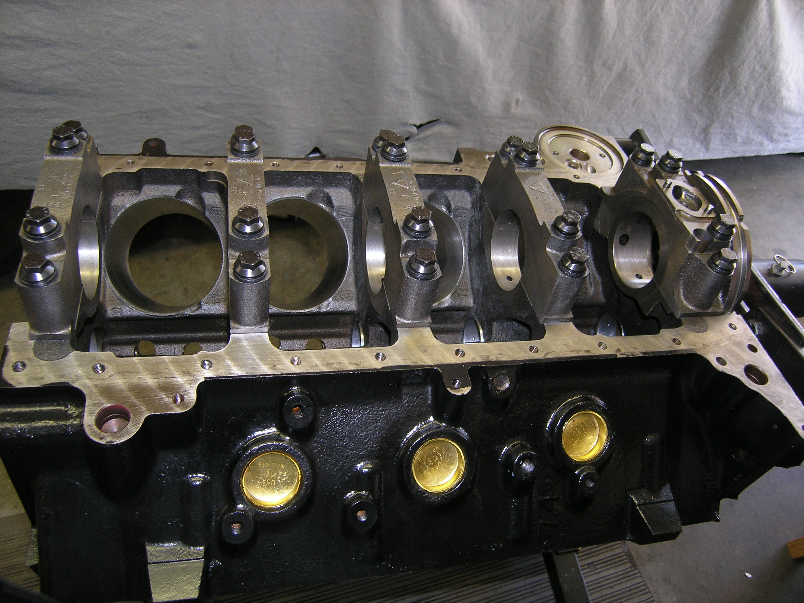

A lil more to it than just finding the caps & tappin sum holes ,machine work is required, block must have the recess machined into it for the caps to be properly seated, then the holes for the caps will be drilled & tapped , then the block will need to be line bored
Sorry for the HUGE picture but wanted to show the recess that the main caps fit into
