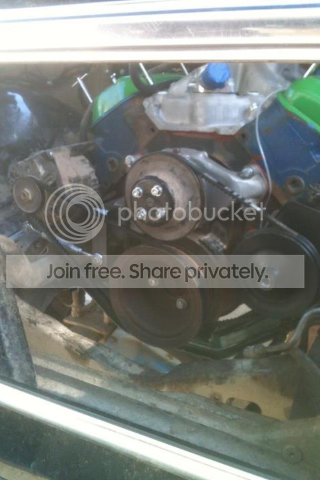

Here's my first setup w/ just plane Jane bolts...
Here's my current setup w/ the Allen head bolts....
