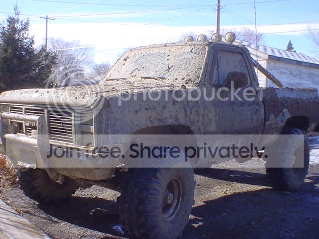

I run 39.5" TSL's on my K5 with a 4" lift, so here is my opinion trying to run the same tires with no lift. You could remove the inner fenderwell and trim the outer fender, but I believe the issues would be the doghouse (cab) and core support. You could do a customer core support to give you room there but still have the cab to deal with. I would think it would at least require moving the front axle forward along with the normal trimming and hammering on the cab for clearance.
agreed... my 78 fullsize with 6" and 40's (measuring 38.8) sit on the cab now...
About 5" of lift (56's with axle 2" forward) and 42's
Required a slight trimming of the core support and inner fenders, and major trimming of the outer fenders.
I didn't need to BFH the cab though, probably since the tires are only 14" wide, and my wheels doesn't have excessive offset.
Doing this with no lift would require complete removal of the inner fenders and major trimming of the core support.
But I think it could be done, so I say go for it:waytogo:

I do have a set of 2 1/2" Tuff Country's in the garage. Maybe I'll use those for the front, just to have straight springs instead of the old sagged reverse arched ones on there now. Thanks for the pics and it gives me some good ideas. I'm going to try and do it without moving the front axle up. Cab cutting won't be an issue if needed.
