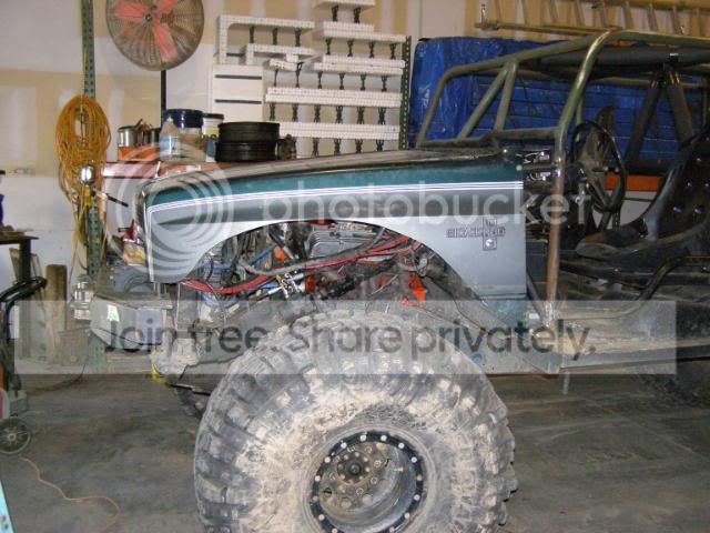

Here is about 5" lift with 42" rockers, the front axle is 2" forward which seems about right, I did trim the bottom of the core support, inners are trimmed, but I have no contact on the firewall area.

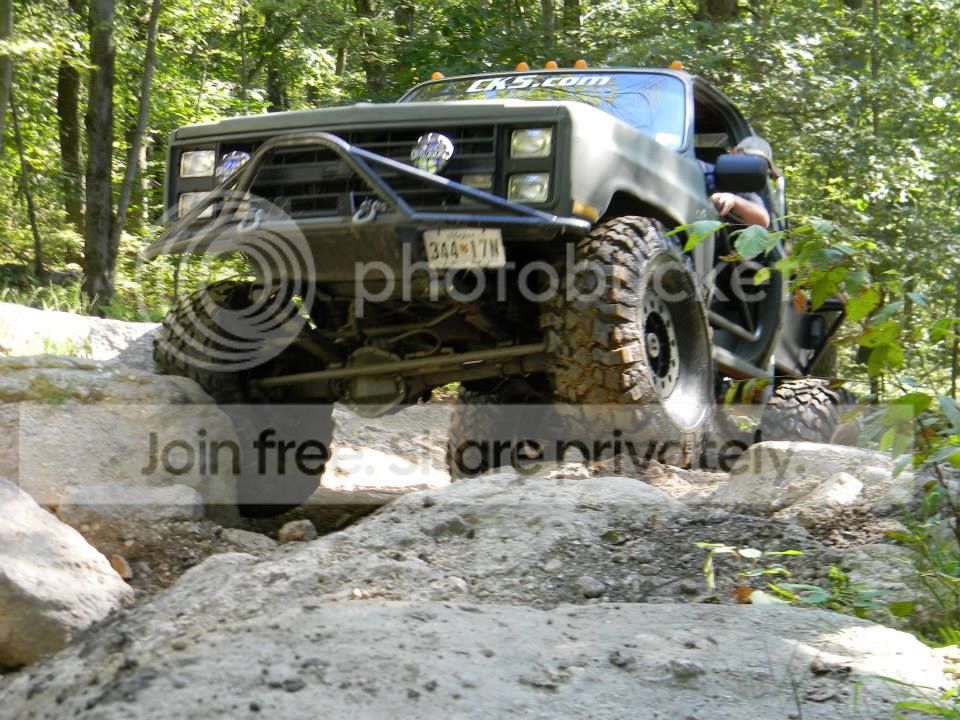

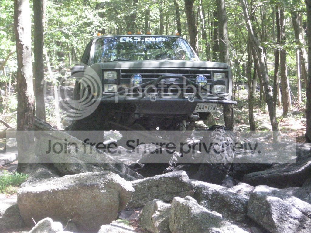

I'm bumpstopped for about 3.5-4" of uptravel but have right about 10" down (15" travel shocks and use almost all of it)
Ok I admit this is not so much Blazer any more but I still call it Blazer.
39.5" Boggers, but the lift, or lack of it, is harder to measure.
Lets say the height to the door window is 51". I still have 4-5" to the 2" bumpstops.
