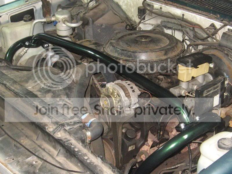

I have Superlift 4" springs up front on my 90 K5. I'm pretty sure they're Superlift, yellow bushings. Stiff, and I'd say almost as stiff as my old Rancho's i had on my 81 Jimmy. I have 5150's mounted vertically up front like this:
It's still a jarring ride up front, combined with the short K5 wheelbase and not so flexy 52's in the rear it's like riding a bucking horse sometimes. I know I can get rid of the bucking ride by adding some longer softer rear springs, but that isn't going to change the ride the front springs have and how they can be bad over medium bumps.
