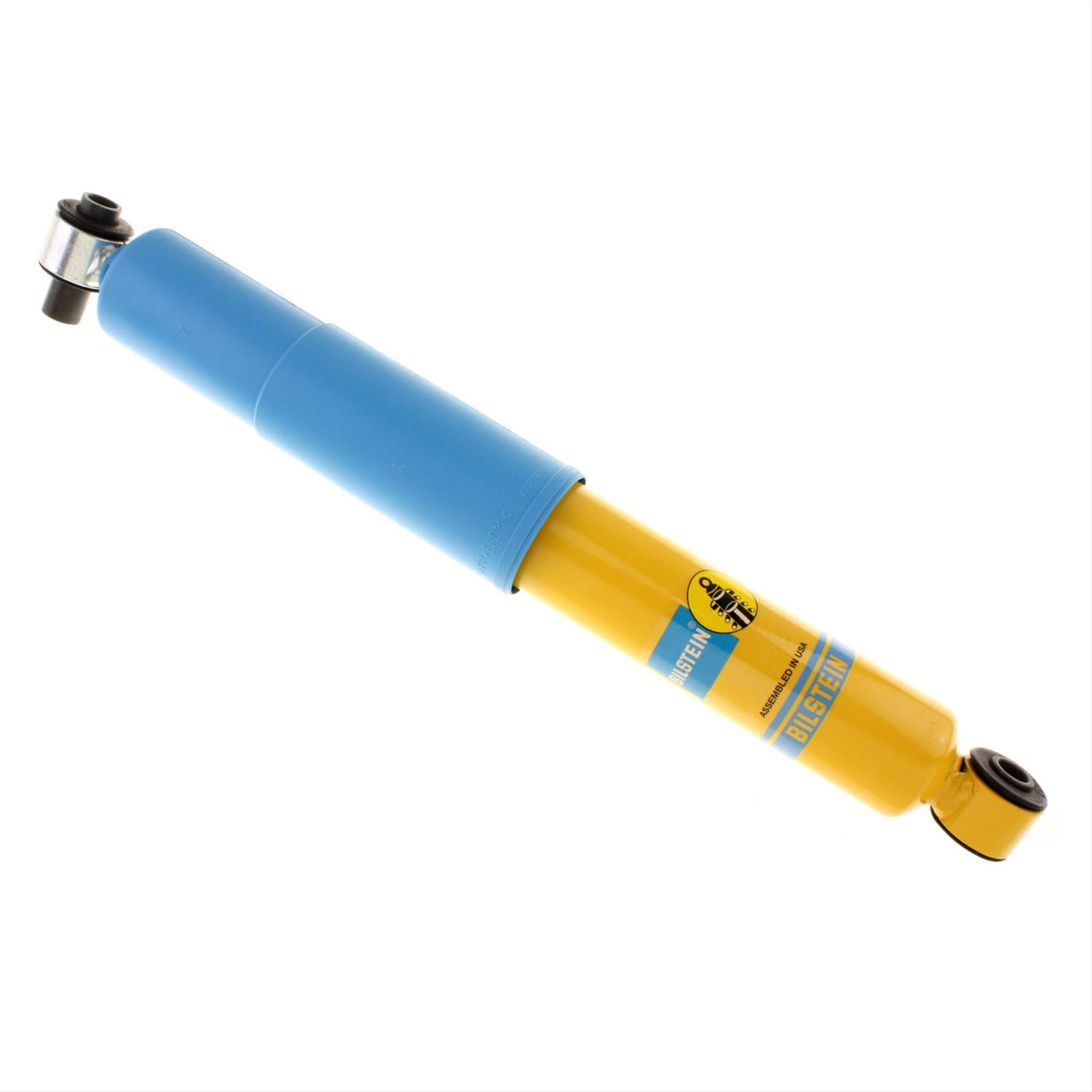

So I ordered some shocks from summit and after reading a lot of reviews on here that I should just spring for the bilsteins since its stock height and I don't really plan on doing any lifts and etc. I also just want to do this job once.
I ordered front and back (obviously) but the front set doesn't appear to be correct, the rear's looked good though.
Here is the stock shock and all its 26 year old glory:
This is what I got in...
The long part number on the shock matches the longer part number written on the box
The rears have the part number 24-009331 written in black on the shock itself, this shock does not have 24-009232 written on it anywhere but F4-B46-2093-H0 is listed on the sticker and on the shock.
it also came with 2 bags of these:
Still not sure how its supposed to bolt up, this is the image that the website shows ( and it looks like the correct one with the eye lid mounting position)
The picture shows -H1 which is puzzling why did I get -H0 in...
Are these in the wrong box? is this some sort of weird superceeded part number confusion? Has anyone had any experience with these 4600 series? I'm about to call Summit, they are usually good at sorting things out but I wanted to make sure that I wasn't crazy.
So I called summit and got it straightened out they are sending me replacement shocks, but the ones they are sending are part number 24-010269
Bilstein's catalog online shows this to be a rear shock for a G20 van and other sources ID as an auxiliary shock... (maybe part of the quad shock setup?) Their catalog also shows that the 24-009232 is the right part # for our trucks and it also has a picture that matches what looks like would actually go on the vehicle.
I have a feeling this ordeal is not over yet...
