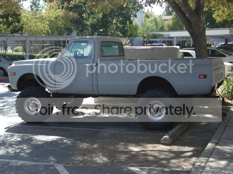

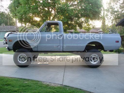

started off with a 1970 Chevy k20,
had a 496/350/203/3/4tons w/4.56 locked fr/rr with 35's
put a 6" lift with 3" body and rocked that for a few years till I moved away to college.

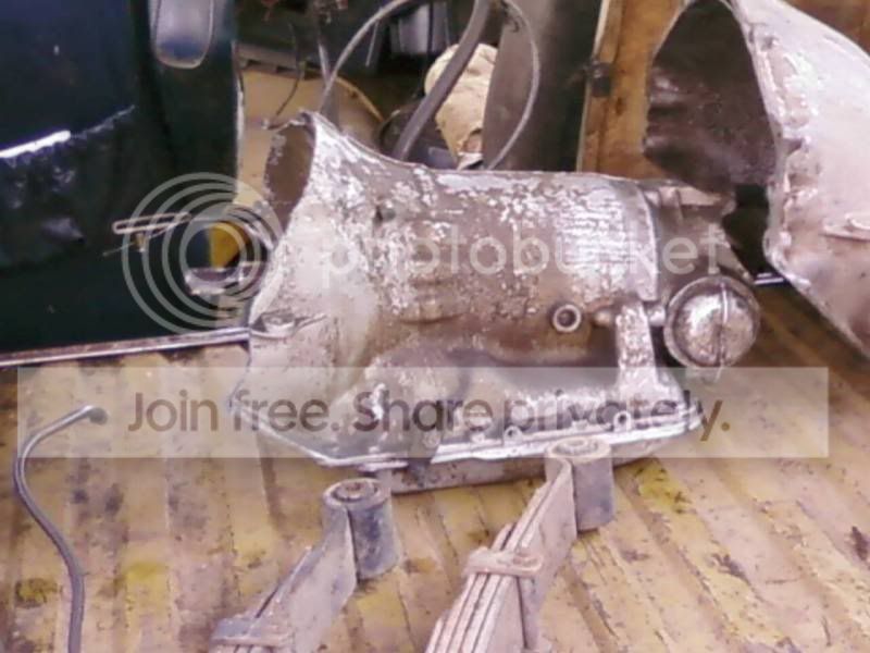

blew up the th350s case so I swapped in a 4speed along with some 38s

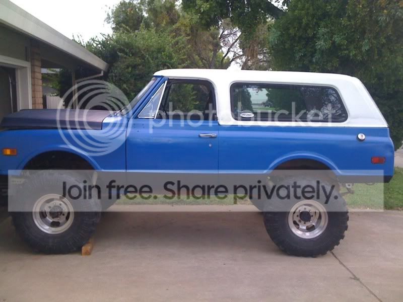

swapped the 6" from the 70 to the 71 along with the 38s

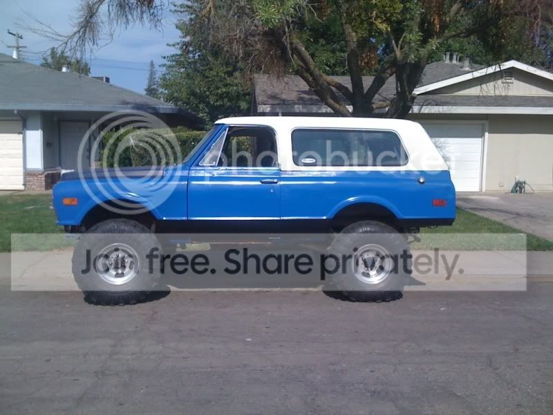

popped some rollers on and into the man cave it went

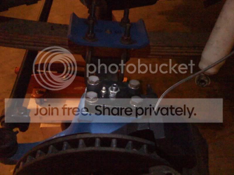

bite the bullet and bought a mid 80's dodge D60 with 4.56s for the whopping price of $650
did some dealing with a buddy of mine for some srw dodge external hubs
cleaned and inspected the 60, and painted it.
did the 52" swap

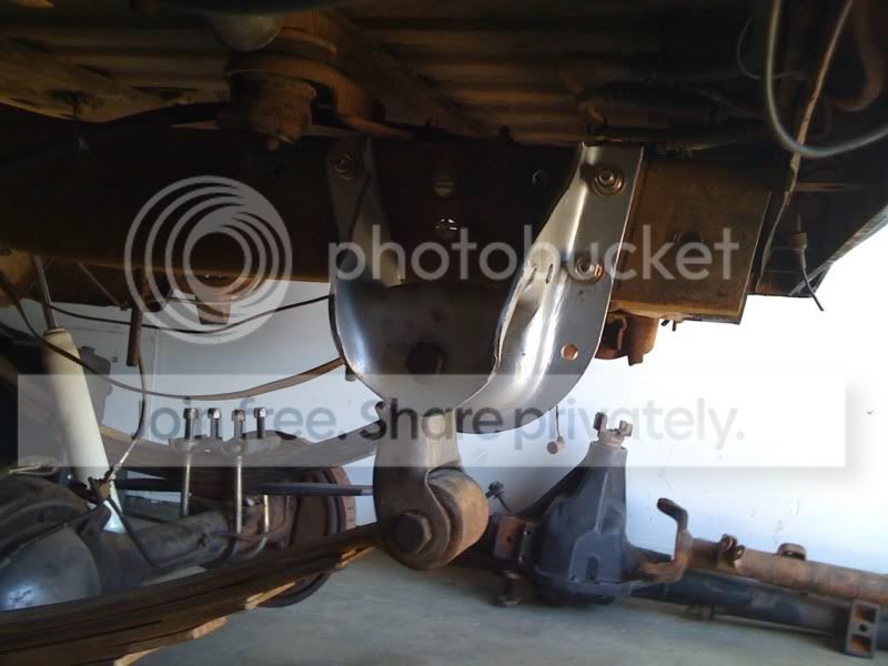

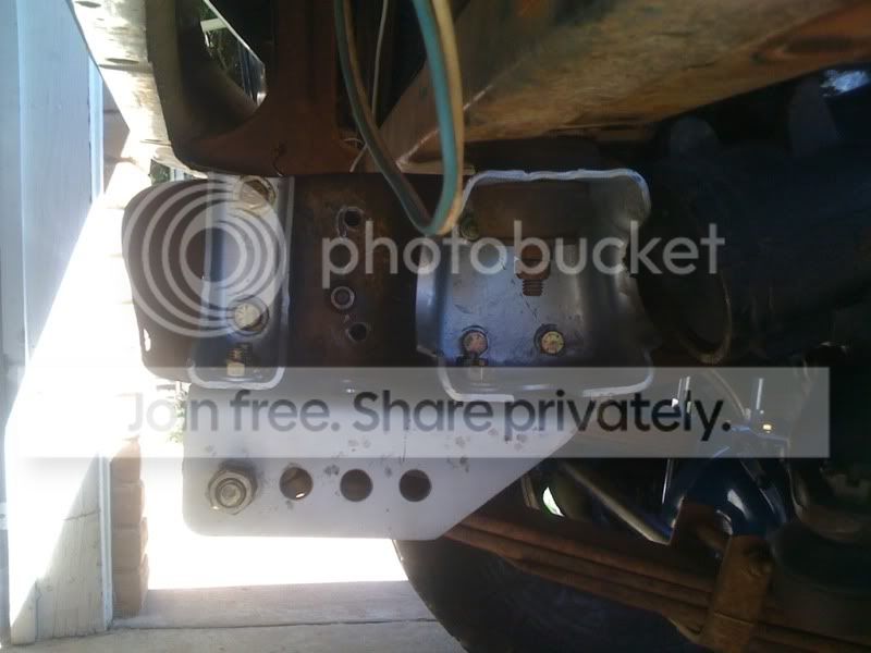

used the bracket off a mid 70s k5 along with the core support bracket and some of Kurts adj. hangers
did a shackle flip in the back with some 56's flipped around to gain 4" of wheelbase

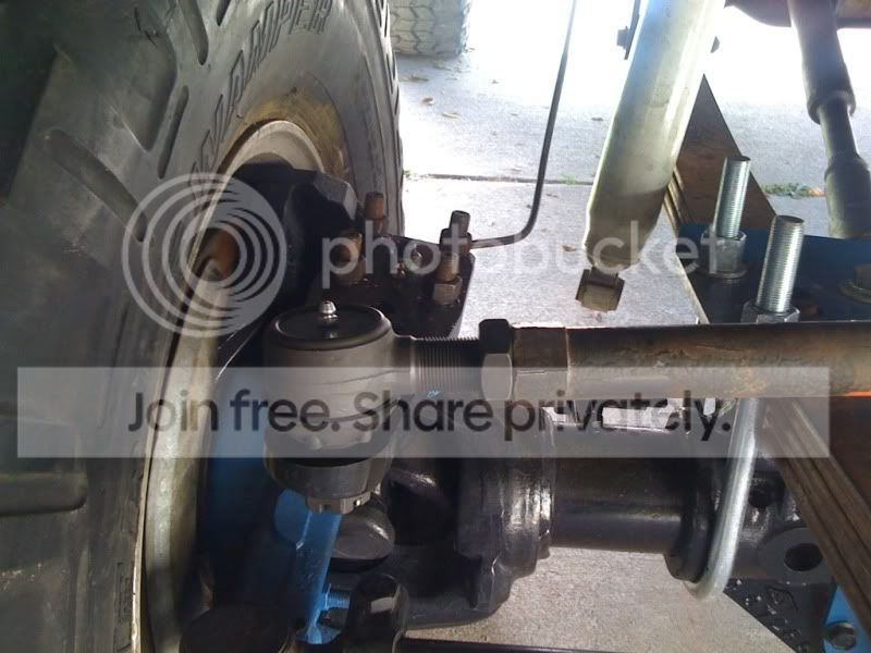

back on track, I went and ordered up the same crossover arms as NorCal Chris did, which for the price, I couldnt pass up
got my drag link welder up, installed and went for a test run.

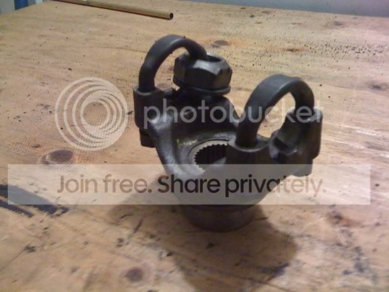

now for the front driveshaft, I needed a conversion joint at the axle end.
my stock shaft used a 1310 but the front yoke on the 60 had a 7260 series ujoint and what a pain it was to find the right one.
so knowing that i didnt want to have to shell out $25 for another one if it broke in the future, I decided to pick up a 1350 series yoke just in case
random pics

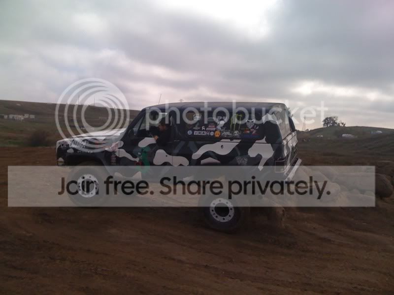

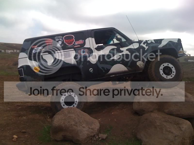

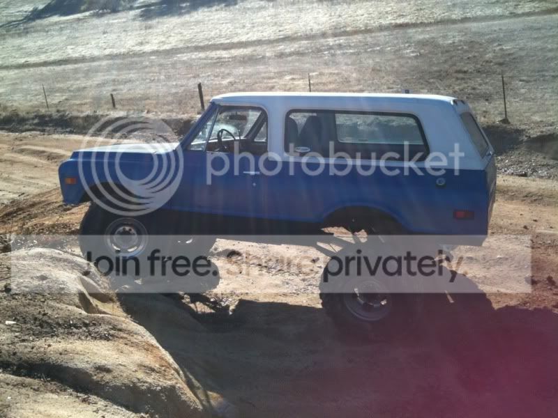

Went wheeling today with Mike (The Beast_88K5) at Prairie City
Problems with my clutch and lack of traction made it to be a very frustrating day but somehow managed to have fun
Mike on a rock

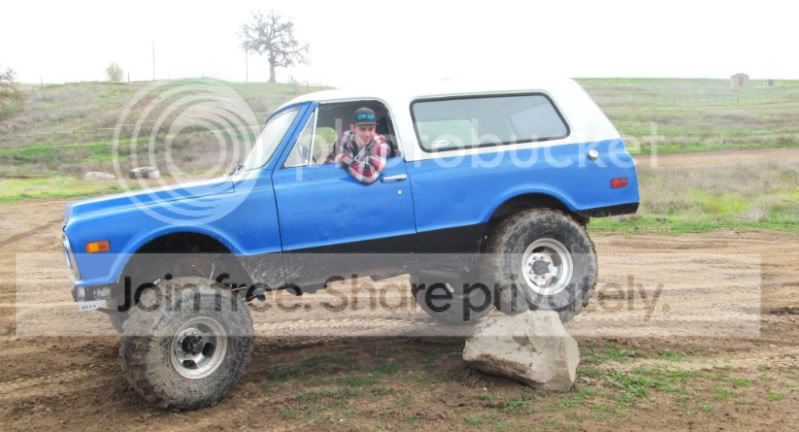

Me on the some rock....it was at this point that my truck decided to just randomly die:confused:

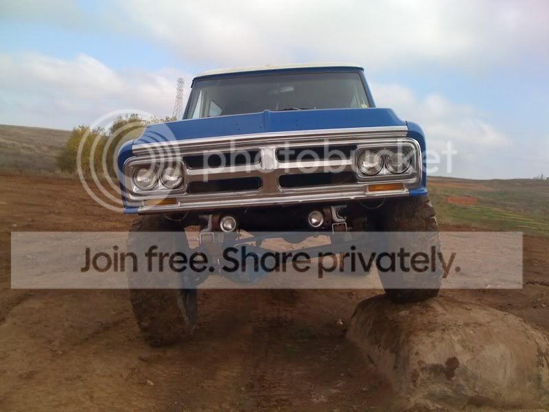

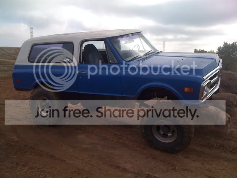

Gotta love the look of a sexy first gen

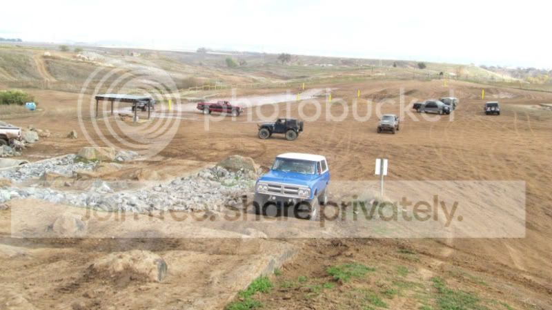

"Attempted" the stair case...but went nowhere fast cuz of traction...again...my Detroit would help with this issue:whistle:
Mike showing what I could do IF i had some type of traction aid :haha:
I also "attempted" another obstacle that insisted on halting me in my tracks and resulted in having mike tug me out backwards:thumb:

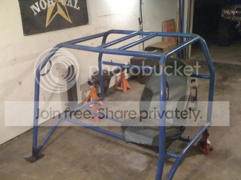

So since Mine and Mikes adventure with my detroit I figured it was time to get a cage going for this thing...you know the whole saftey first deal.
So I hit up NorcalKid about it old cage since he got a new one. Figured it was a good start and it has been.
Did some "maintance" and went to install it...removing the top got quite "interesting"...Ill just say that there were 4x4 blocks, some straps and my gfs frontier involved.
So anyways, got the top off, went to put the cage it and the cage didnt fit past to windshield frame...tooo damn wide. Played around with multiple ideas to remedy the situation but ultimately decided to get new A pillar bars bent up.
So after one hell of an experience, Im once again cageless...for now.

The cage...had to cut the back support bars do it could fit in my garage.:whistle:

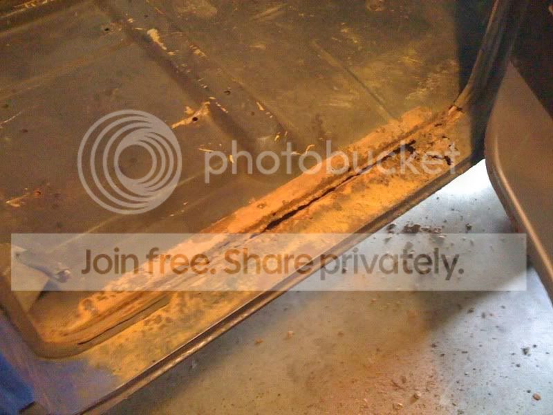

Got new replacement rockers from my pops so did some prep...the otherside is 100x worse:doah:
