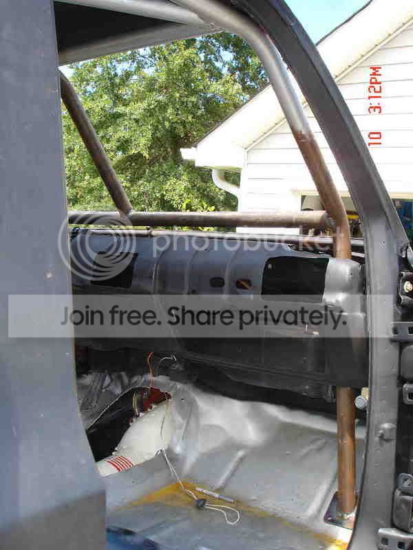

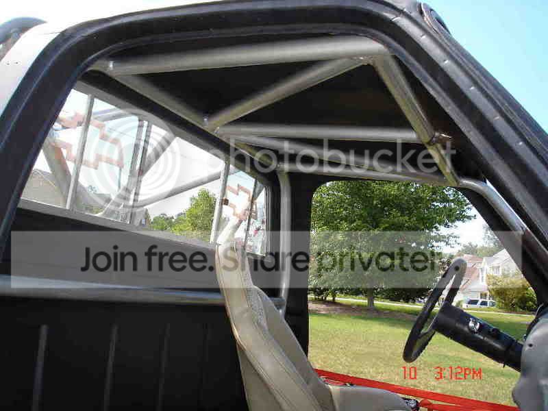

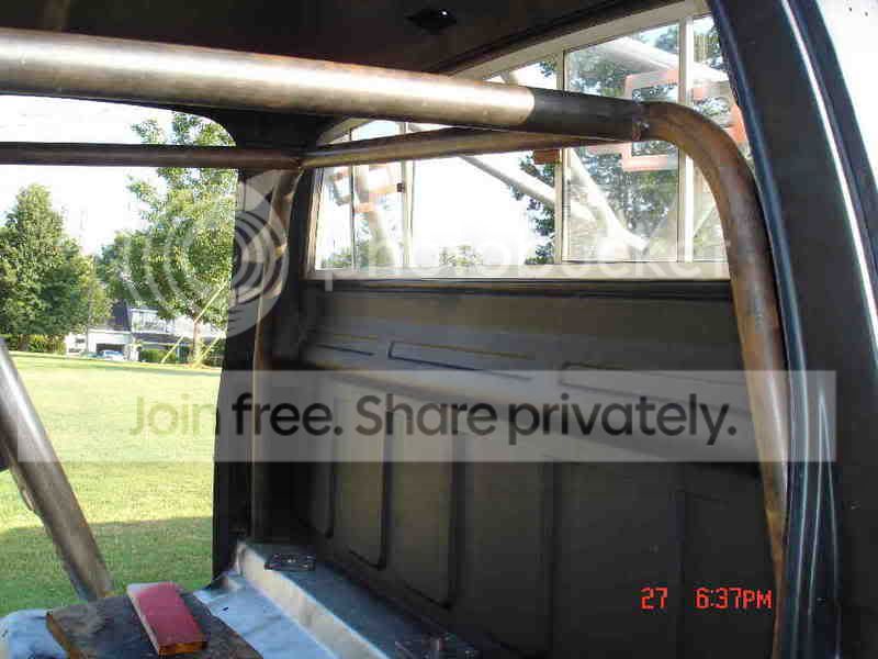

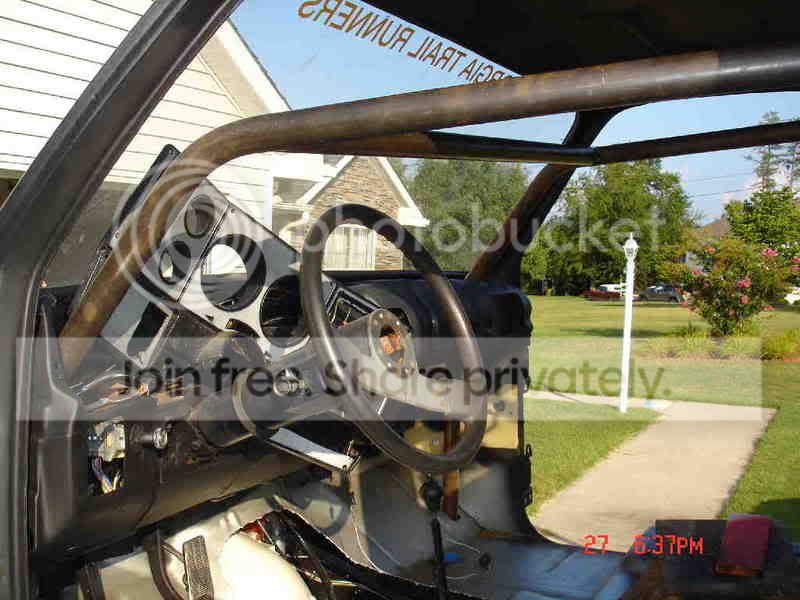

I sure am proud of my first time bender work. Much cooler going through the dash than some of the other cages ive seen. And the rear hoop is about perfect with about just enough room to slide your finger behind it all the way around. not so proud of how my welds look but trying to make nice welds in tight spaces isn't easy for a beginner. All I could think about was how many welding articles I've read that stress building a million things before you weld roll cages. lol. Shes burned in good, just not pretty.

Maybe I'm missing something (and I'm sure I'l be corrected if I am) but that cage seems a bit low, like right-across-your-eyeline low. :dunno:

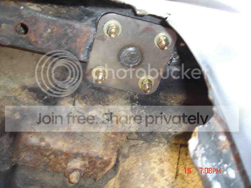

Thanks Ben. In the one picture it just looked like the tube was bolted to the floor on the passenger side over there. Nevermind. :crazy::)

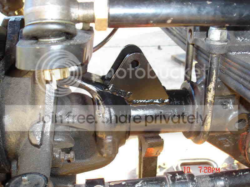

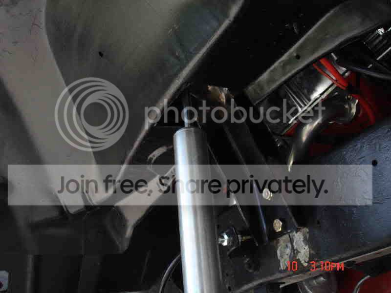

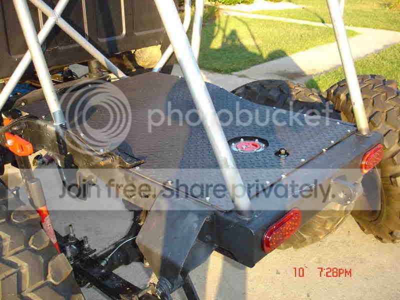

Well heres some more pics. I ordered a driveshaft up from carolina driveline. 1410 at the D60, 1350 at the tranny (dont have 32 spline output for np205 yet) using a superflex joint at the transfer case. 12" of slip. Waiting on some tabs to make the seat mounts. Still need to tie the roll cage into the frame. 14.5" travel bilsteins are just a tad too long for the ford towers. I need just a little bit more uptravel but I have the towers mounted about as high as I could get them without modifying them more. Also made a "bed" for the rear
