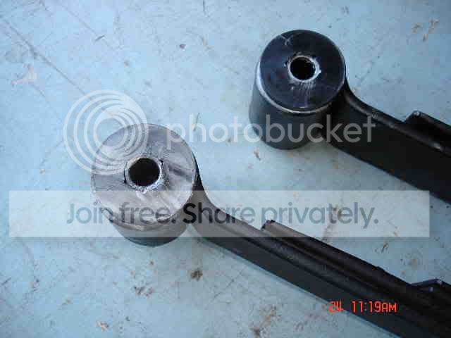

Painted the front bumper, and the longer springs for the front as well as put poly bushings in them with bigger 9/16 greasable hardware...

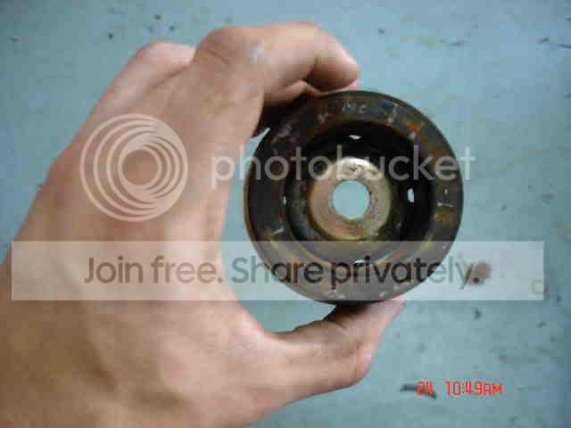

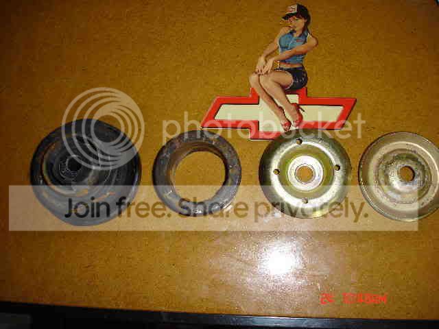

Found out my new body mounts were holding water and modified the cup washers with some drain holes. I think this is why our trucks rot out at the body mounts. Something to consider if you havn't allready done this.

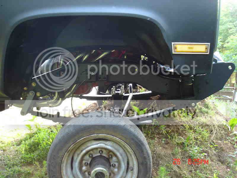

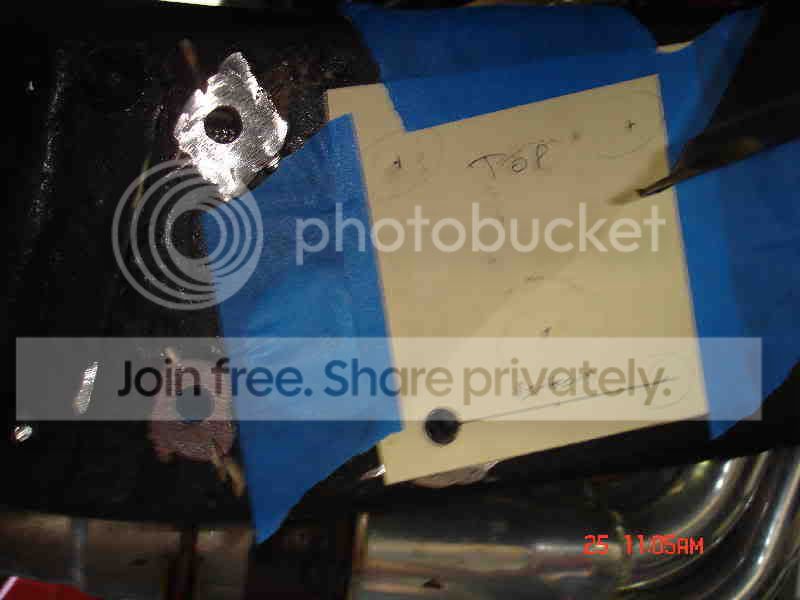

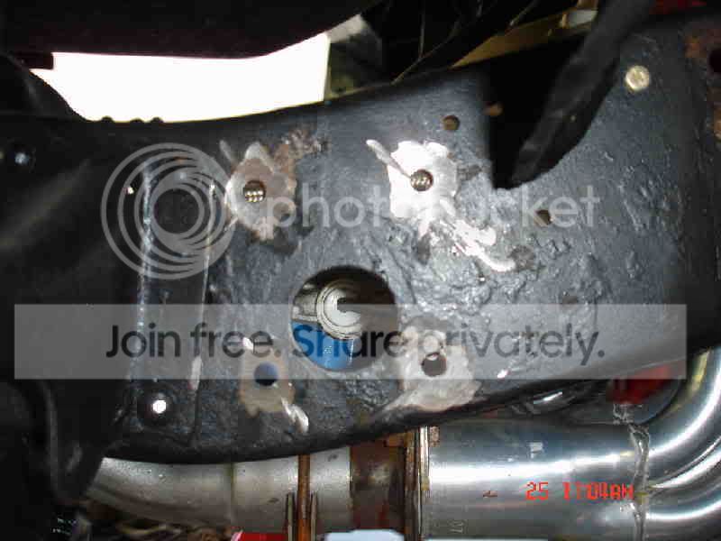

The 52" spring swap. Using a hole saw on your frame is NOT fun. The runout on the bits is horrible and its a violent process. A plasma woulda been nice to have. Also welded up the other 2" hole in the frame with the slug from the new holes. Got the springs and longer shackles in. She should flex out nice now.
No after shot here just the template I made and the old hole.

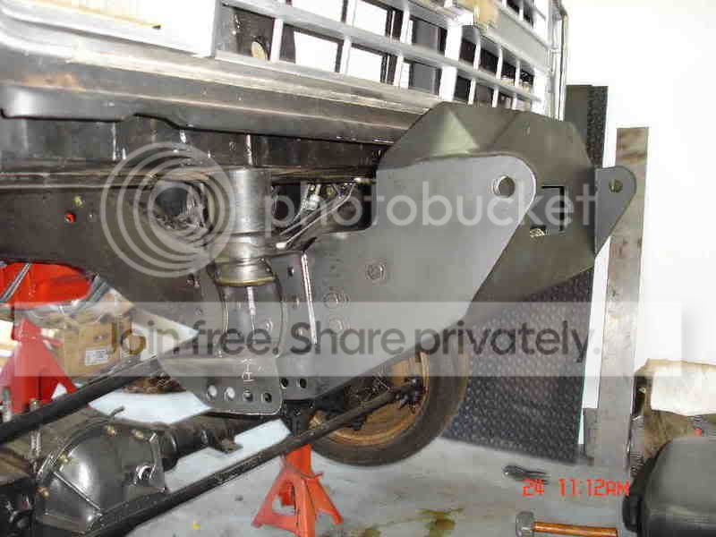

Modified my F250 shock towers but didn't to much but weld them back together..

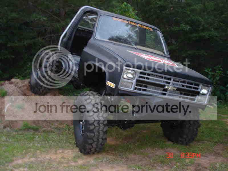

Then after some hicups with the tranny and not having enough fluid in it I got to putt around the back yard with the truck. The rear pinion angle is horrible but ive got new perches to fix that. The brake pedal goes all the way to the floor but it stops good. Heres the classic poser shots but it was nice to have the truck in a change of scenery...
That's a midget truck to go with the midget welder :haha:
I mean, with those pizza cutters for rollers, you might have had to do some winching to get it down off that dirtpile :haha:
More usefully, I assume you bent the shock towers in so as to clear the inner fenders, wheel wells, whatever you wanna call 'em? I got the newer cast towers, which are great, but are not tweakable the way those are ... and I had to notch the well where the shock went up.
-- A
They're bent to clear the steering shaft. I'm still gonna have to cut some of the inner fender for the shock to fit through.
Holy crap! I take it you're mounting the shock on top of the axle? Well, maybe with those tall-as-the-midget :D shocks, you could mount them in the stock holders and STILL need that much room... wow.
-- A
-- A
I really didn't take any measurements cause I dont have a way to flex the truck out right now, I'm just going off what others have done. And yes the shock mount will be on top of the axle. DIY4X D60 tabs.
