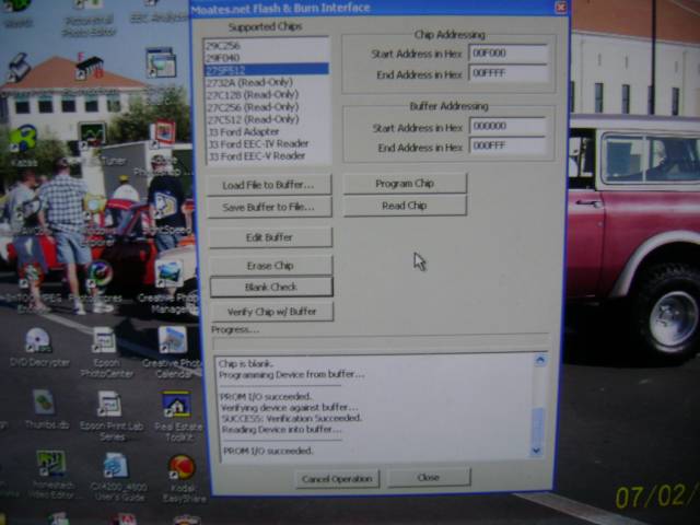

I'm not sure if I had the offsets correct. I basically used the addressing exactly like this window shot from binder planet. Was this wrong?
That looks just like the information I posted back on page 11 of this thread. Did you verify chip with buffer after flashing? I'm thinking the no spark is not a chip problem, but something to check because the engine now has, no start / no spark. I think if the chip was the problem, the ECM would set a code, (not sure of the code number). I think the engine will actually start without a chip.
