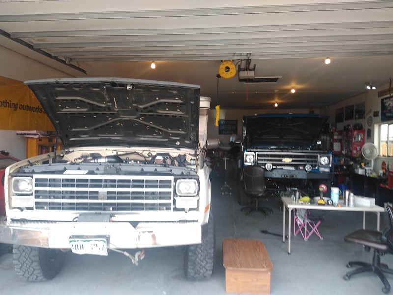

Went over to Larry's place to help him put the hood back on his K10.

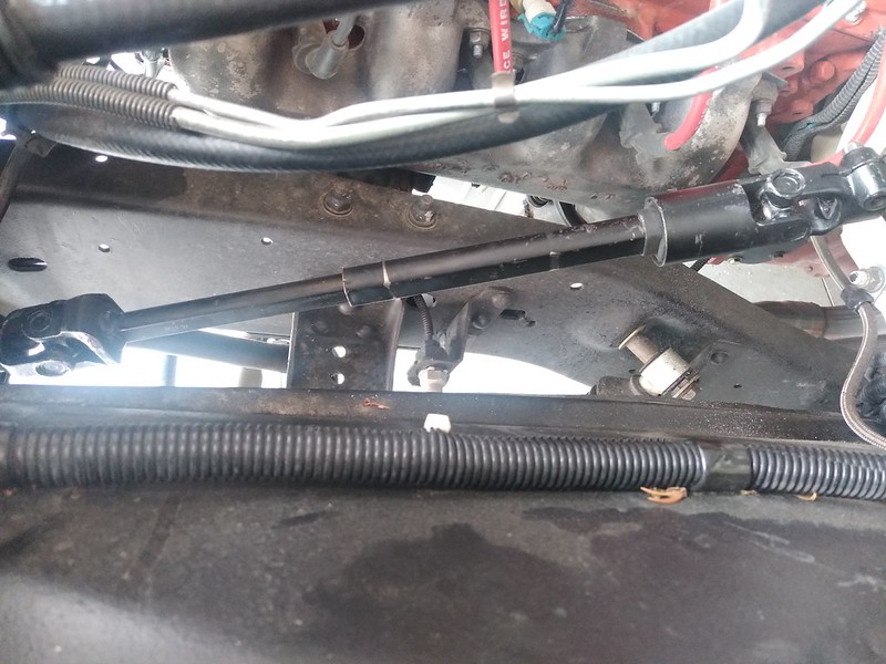

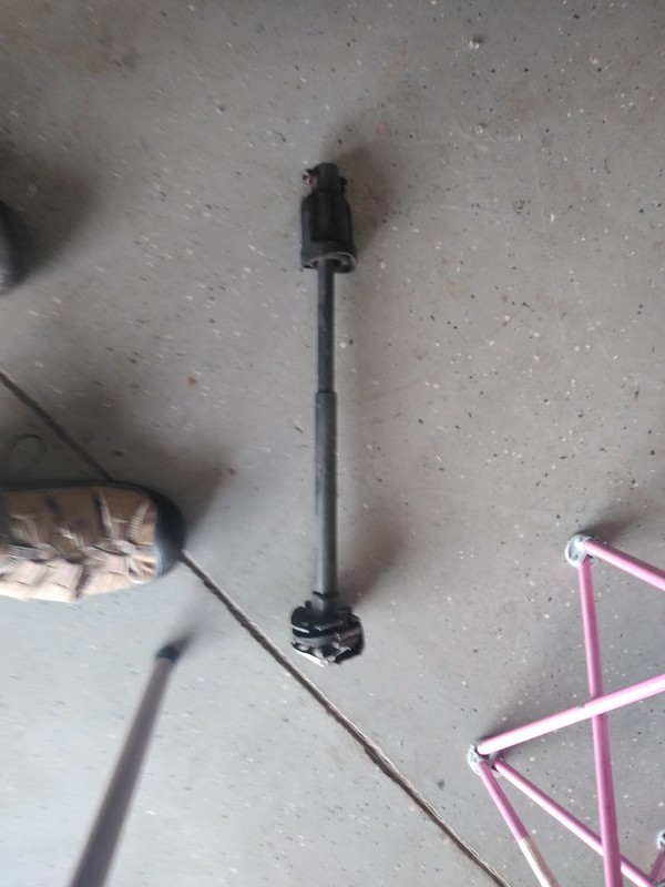

Had a little time on our hands so we tried out the XJ intermediate steering shaft install on mine.
Out with the old shaft and rag joint
Installed.
The hardest part was hand filing a groove on the end of the steering column to allow the upper pinch bolt to pass by.
Felt pretty good on the ride home. Worth it.
