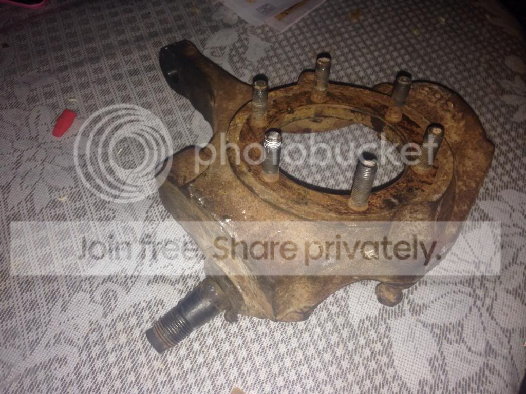

I happen to have picked up a d44 flat top passenger knuckle at the salvage yard just a few days before I got my D60.
I would sell it if someone wanted to pay for shipping.
I'm considering putting it on eBay.
I know I'm not supposed to post that here, but I'm just trying to help an ol' boy out.
It has a bit of hammer rash from trying to get the ball joints loose, and I'll press out the remaining upper ball joint.
