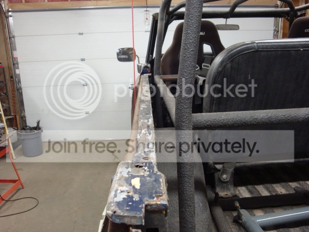

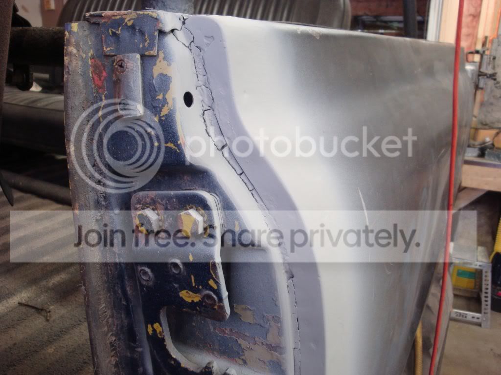

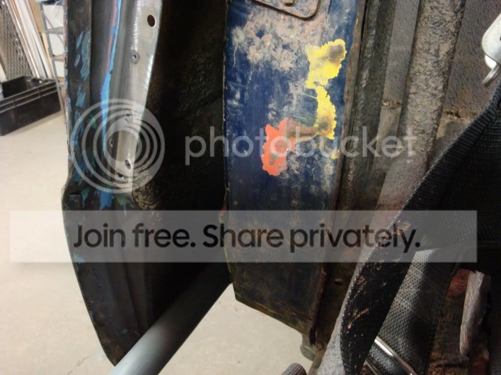

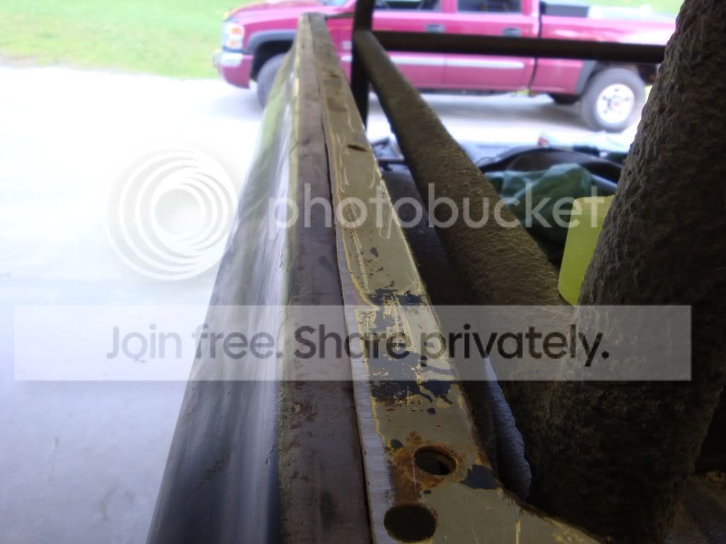

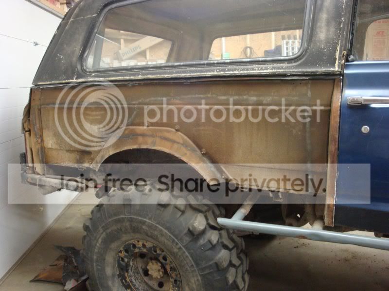

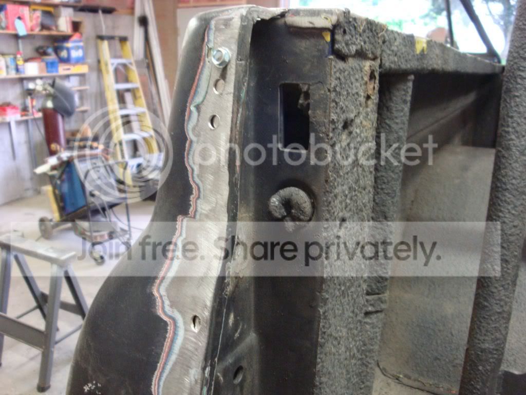

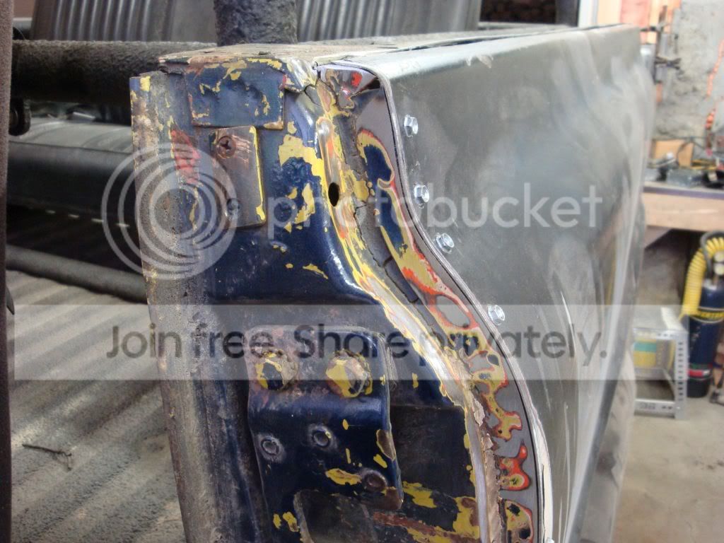

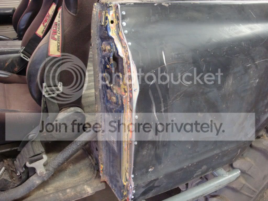

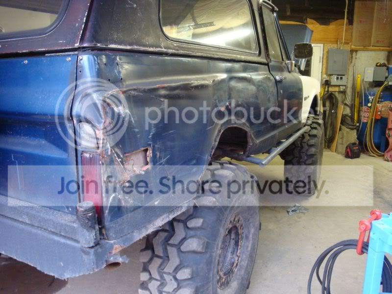

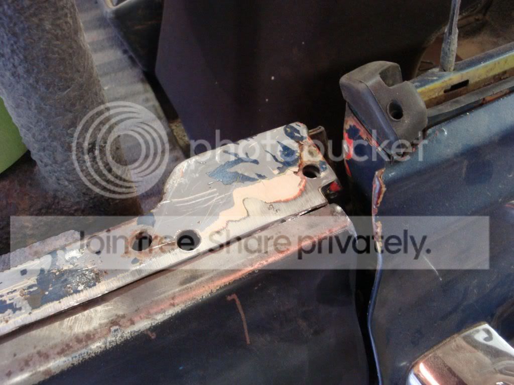

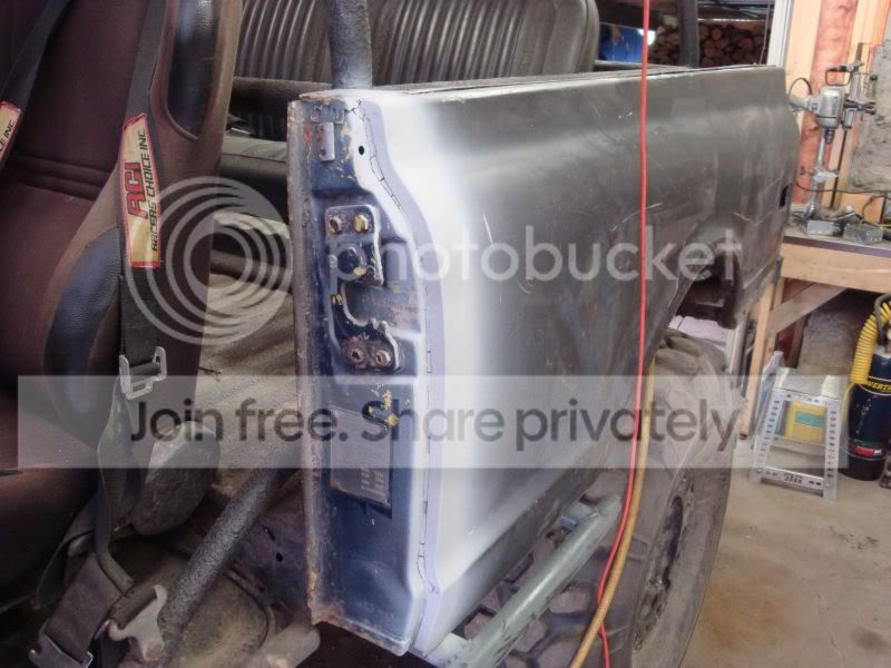

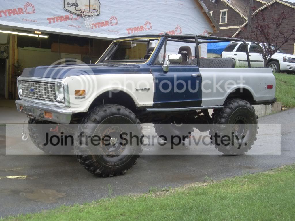

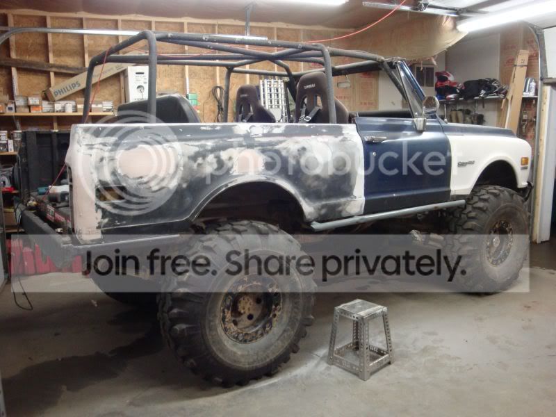

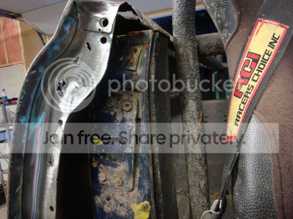

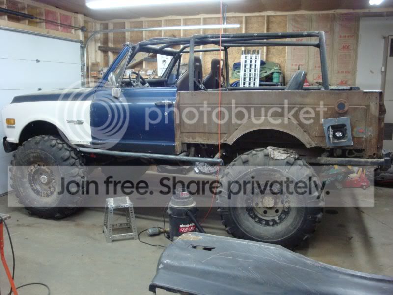

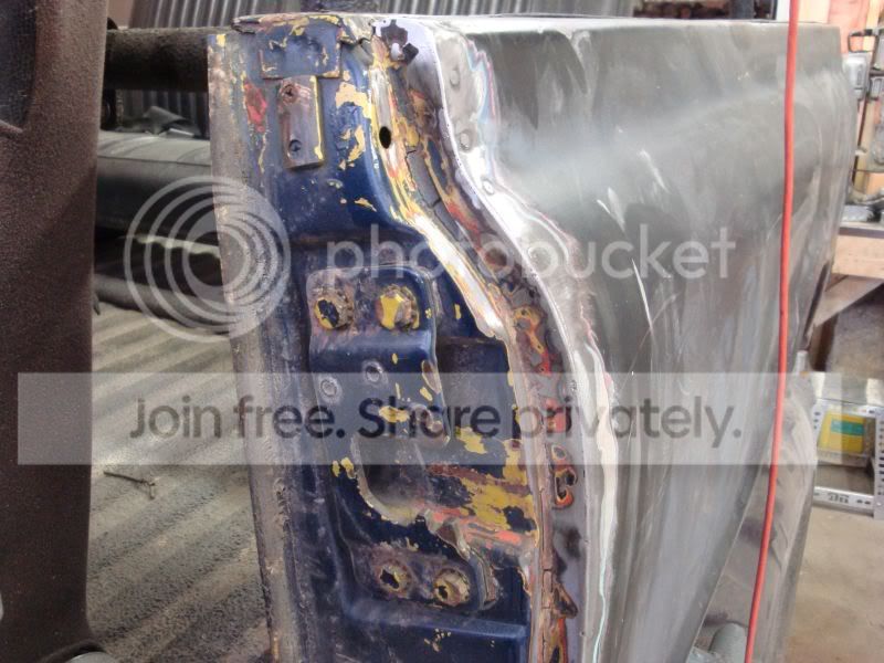

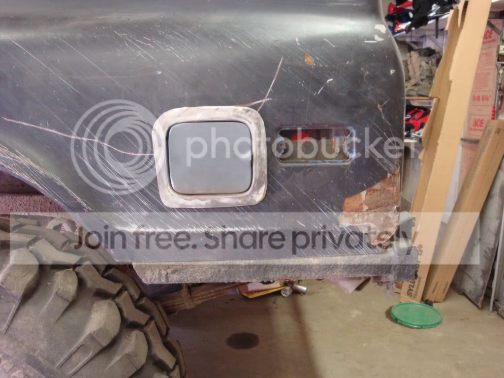

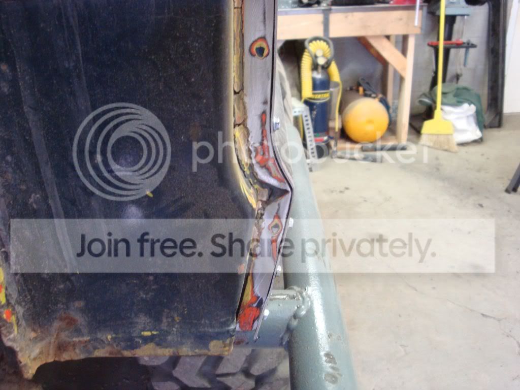

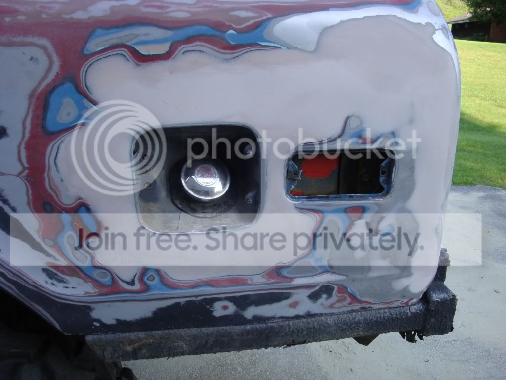

I had the need to repair a set of completely bashed in quarters awhile back and pulling the existing ones off simply wasn't going to happen.
The tub had sprayed in bed liner and the full cage covered all the inner bolts around the wheel tubs.

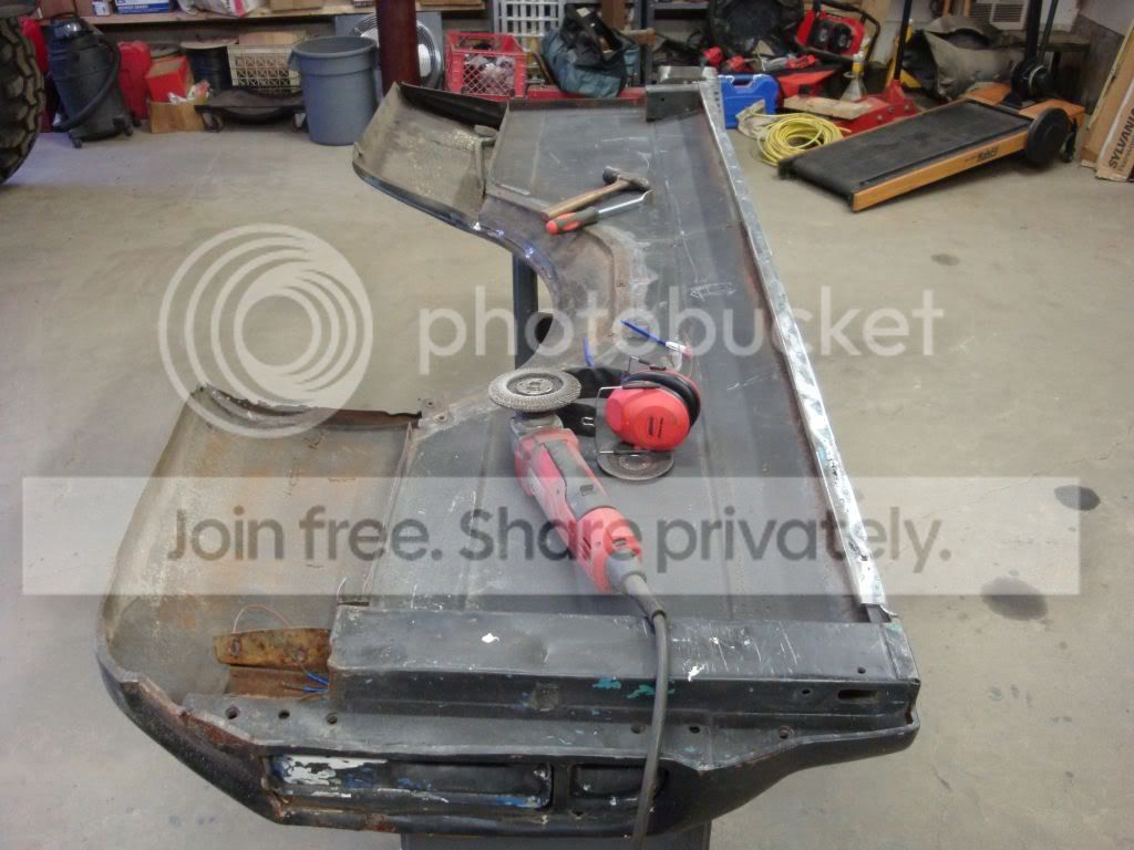

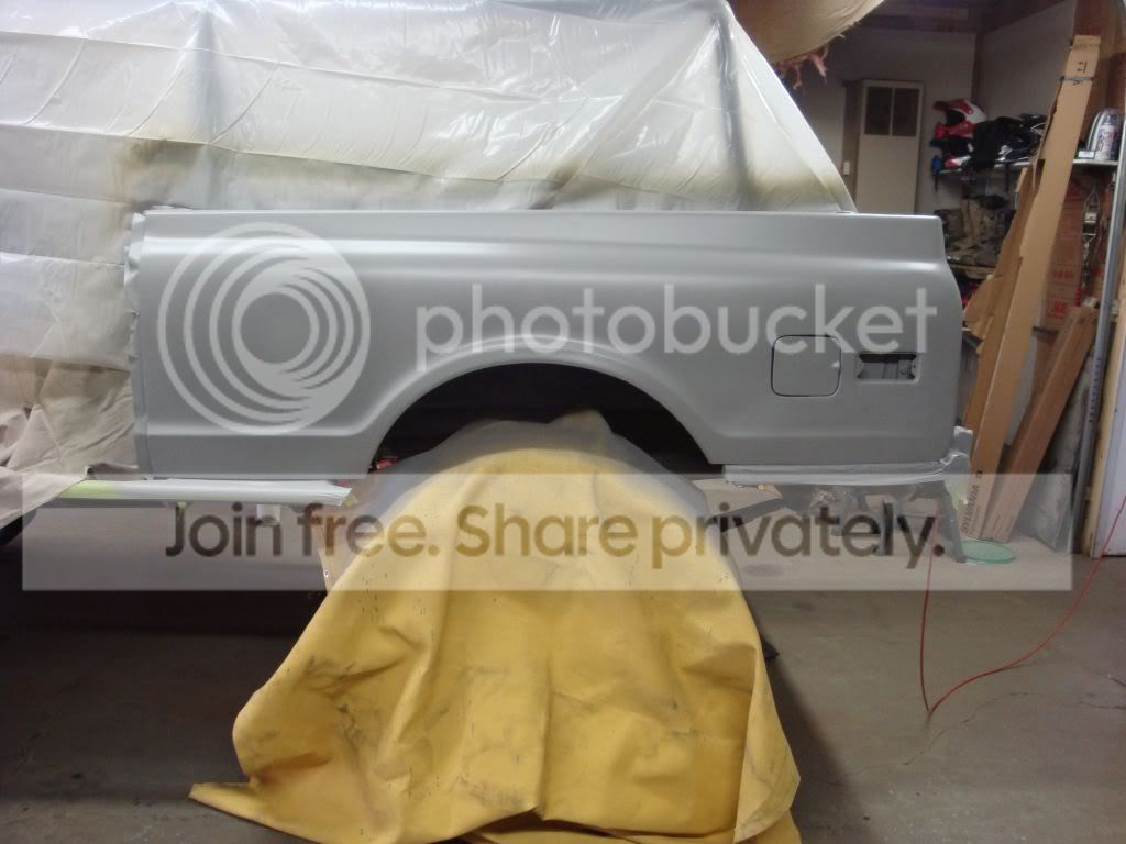

What I had to work with were a decent set of bedsides from a swb truck, they're longer in overall length but have the same dimension's between the wheel opening & the rear tail lights.
So I decided to re-skin em.
Starting the pics from the beginning so you get an idea of what I had to start with.
Every dent tells a tale.

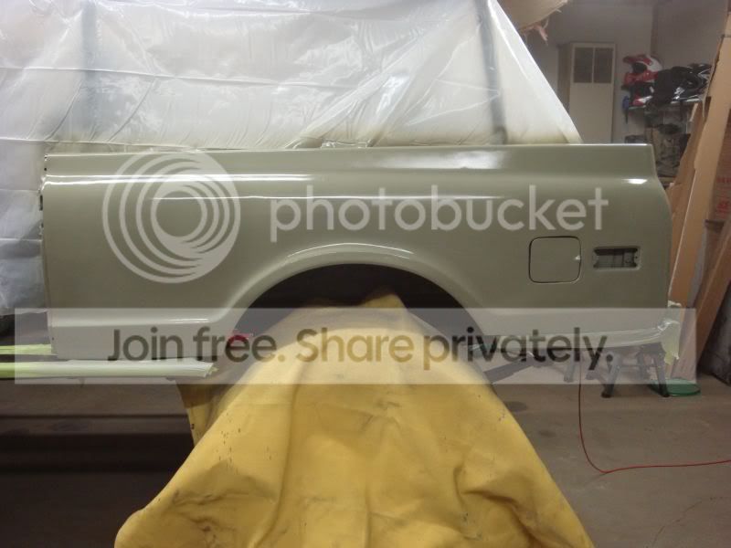

started to late in the morning...stupid job.
Ouch, Thats the kinda damage you just gotta grit your teeth and keep movin
