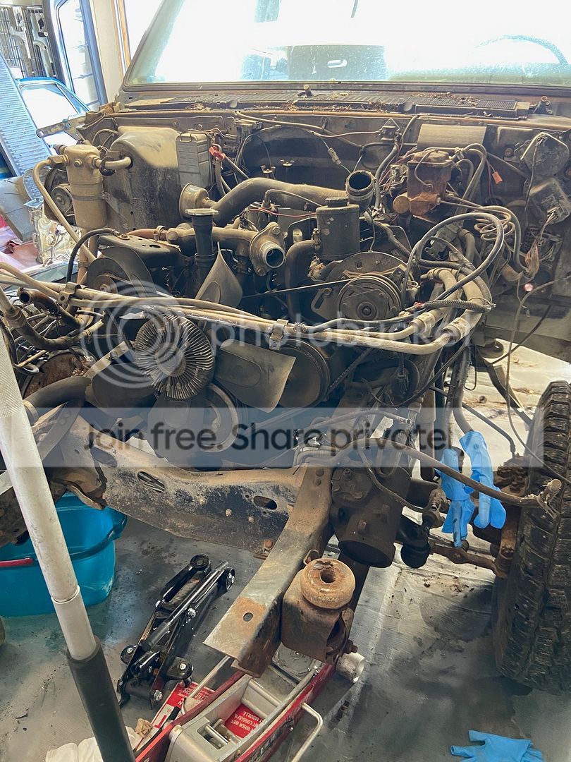

With the self isolation we are finding it hard to get motivated. Working on our build '88 K5 conversion to '78 body style with 6.2 diesel. It needs a lot of TLC!
Thinking of getting started by removing the front rad support. Will have to drain all the fluid and disconnect lines. I can then do a mockup of the '76 rad support and see if I have to do any modification to work with the 6.2 diesel parts, etc.
Where did you all start on your projects? We have completed most of the teardown. Rear quarters need attention. Rockers need replacement. Would like to make the frame look nice, so assuming this means body has to come off..
I'm thinking once I have completed the mockup of the rad support with 6.2 accessories and determine all is well/done modification, then I can start to remove the body and get geared up to sandblast or grind and paint the frame.
What does the CK5 brotherhood have to say on this? Thanks all
Sounds like you have some work in front of you...
I completely finished the suspension, axles and all frame & Drive train before getting started on the body...there are a lot of small details that make it so much easier to do in that state
