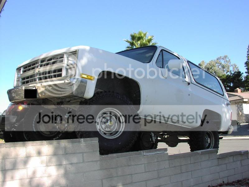

Well, I purchased a "Mighty Vac" from harbor freight and it worked awsome!! Brakes are much better and stop pretty good. Now that the extended lines are on, I gotta find a place to see how much this bitch flexes:) Oh yeah, also want to see if these new 35's will rub with my 4" procomp lift!
Looks to me like you've got a built-in ramp right there next to the truck. :D
:haha: Your so right, but i already thought about that one. The bottom portion of that ramp has fallen apart, i think my neighbor would be pissed if the whole wall came down:D
