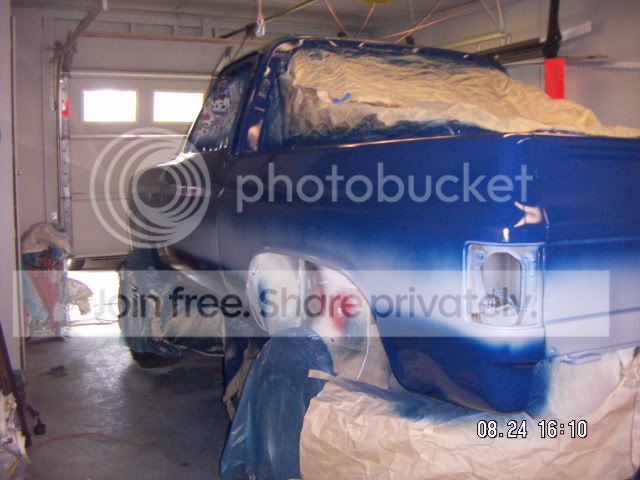

Hey Blue, the atomizing/orange peel I had problems with too, Paul suggested using 40-45# air @ the gun, and thinning a little more. That and my tip was to big really for ideal color, but it worked pretty good.
I thinned to 75% on my 2nd color coat, and clear and it came out much better.
I sanded down the top and shot it again with the new setup, which worked pretty good. The color looked good, so I shot it with clear to make sure that I had a working process.
The pictures are actually too grainy to show the shine. My only complaint is that the dust is noticeable up close. I'm hoping that I can polish some of that out.

The top looks pretty good I think....is the dust your talking about airborne dust that dropped in the paint, or paint dust from overspray?
Either way a wetsand with 1200, and some buffing should make it look real nice.

I shot the silver last night, just like I had practiced, but I still had issues with runs, + one spot where the metallic pattern got screwed up. The only way I found to make it work is keep the gun back almost a foot from the surface and make a lot of light passes. Anything resembling wet just runs or the metallic swims around.
So I sanded the silver and now I'm ready to shoot again. This time I will be more careful on the corners and wait longer between passes. Thank goodness for base/clear - getting the metallic right as a single stage looks pretty hard.
I shot the silver again this morning, running the gun really light. I made dozens of passes, each barely laying paint down. The finish is not very shiny, but the color is very consistent.
You're not supposed to sand metallic, but can't I still scuff it before I shoot the clear?
I got up at 5:30 (am) to do the silver and had the clear in the gun by midnight so I made the 18-hour re-coat window for the silver and avoided the issue of scuffing it.
