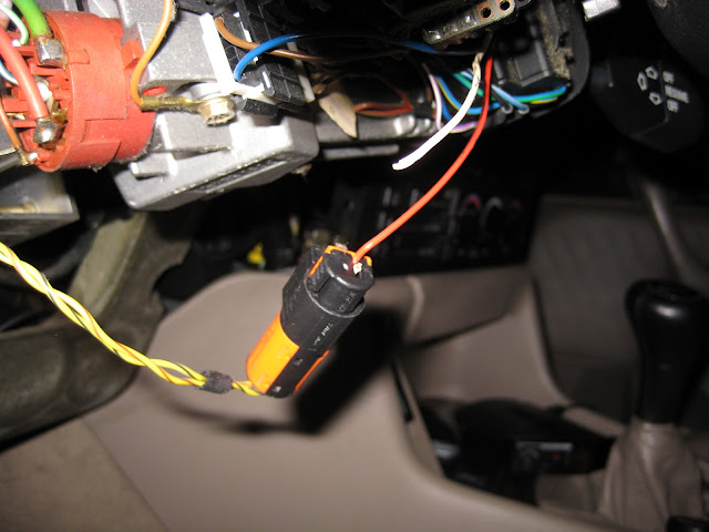

Current problem is SRS light is on. Code read, resistance high in drivers side front firing circuit.
Going to tear it apart and run a continuity test on the little coiled wire firing deal, im sure it jsut needs to be replaced.

Airbag light, Its usually the Spiral spring behind the wheel that causes that.
The loose column, could be a couple things, there is a bearing in the upper column, and a nut under the dash on the shaft, check those.

Well, found the problem:
I'm thinking that white wire is supposed to be connected next to the red wire into that orange thingy:doah:
I guess i COULD try and fix it, but rather than rig something funky on an airbag circuit, im ordering a new spiral spring deal. Wish all the pics/explanations in the bentley manual were for my Airbag II system instead of the Airbag I system though......

The airbag wiring, good guess. I would replace the whole slip ring.
I got your BMW history, but I need your email, its too big to post.
Got the slip ring in the mail today, will install tonight.
Do the connectors that plug into the airbag matter which way they go? It looks like it could go either way, and i'm not sure which was it was facing when i took it out. If it matters, ill probably plug it in whatever way pics from someone else's How-to show it.
Ok, got it all back together, code cleared, all is good! No more airbag light!
