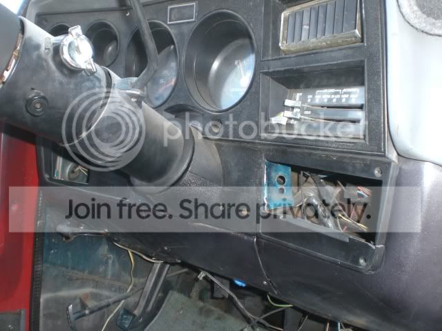

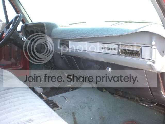

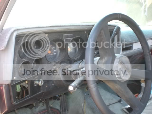

Thanks guys, Kind of a sticky situation I got myself into. Have a vehicle at the shop that was delivered via wrecker yesterday. It was sent to me by a friend who thought I could use the stuff off of it at a good price. It has been his 35 year old sons for years and thought that for the price I could use it. I was planning on parting it out and using it as a donor vehicle. The pink and all the documentation was in the car. went to compare the vin with the pink and guess what... Lifted the dash mat and a big ass hole where the vin should be. Pink slip says its a 1977! So I have a truck in my driveway that I was going to hack up that doesn't have the right pink. Or Vin Numbers... It hasn't been registered for years but has a nice shinny 2013 sticker on the license plate. Can you say, Chop Shop!:mad: By the hinge style on the hood I know its newer than 81. I was just trying to do some Detective work so when I have my heart to heart talk with my buddy tomorrow about his son I can have guns loaded. If I cant get any straight answers from him and he doesn't drag the thing off with him I will be contacting the local authorities.
It's obvious to me thing was probably an 85 or 6. I was just hoping I could dial the year in but dont think that is going to happen. I know where the frame numbers are hidden on this thing but I dont want to go to the trouble cleaning the frame and getting the mirror out. Really Pissing me off that he would put me and my business in this position! Im sure this thing is a collection of many parts so ID'ing will be almost impossible.

Well, the dash pad is 81-91, the dash bezel is 84-later (wiper switch moved to column). Get a pic of where the radio goes and this will help narrow even more.
Steering wheel is late 80's early 90's. Seat patterns would also be different by certain years. Is it fuel injected or carb'd? Body trim and mirrors are also from the 89 to 91 range. I've got a bad feeling that this thing is hot...
Good eye, those are power mirrors though and weren't offered until 1990 so i'd guess this rig is 90-91.

BTW: it looks like the original color of the cab was blue as seen by the ebrake handle.
