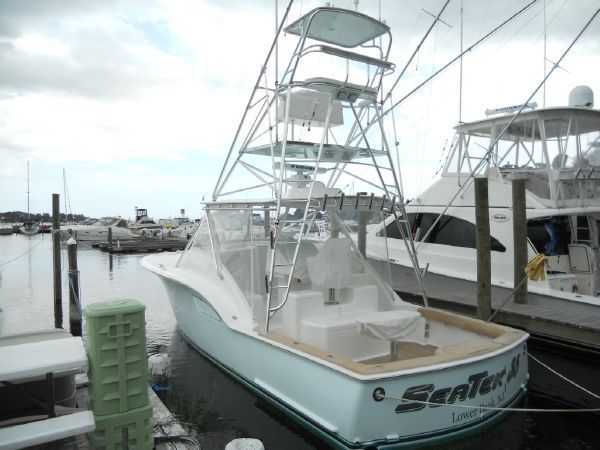

than got in the collision game for about 6 yrs and shot about 2000 cars... since then I've been a mechanic/glass/gel boat guy... structural thru ummm, everything.... :haha: we just built this......
