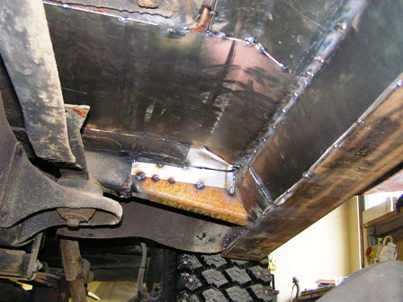

Maybe I'm mistaken about the location of the body mount. I need to replace the brace highlighted in red. Where I have circled is this a body mount?
yep, this is a body mount.
Is this the truck you are working on?
That is worse than the worst truck I scrapped.:eek1:

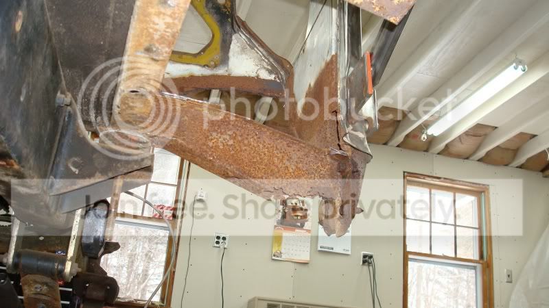

No I just grabbed some pics on the web but my floor support piece is so rotted I can put my hand into it. Here are some more pics I found on the web.
I need to remove the area in red.
When removing should I support the floor brace as I have shown in brown?

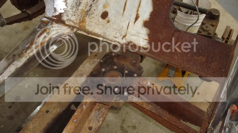

Here is a pic of what I'm working on below. There still is some structural support. It may be sagging a little.
attachment.php
Those are the front cab mounts that you are trying to take apart. It wouldn't hurt to support the floor by a brace vs. just on the sheet metal. I lifted the cab with a block of wood from the back. I placed the board on the sheet metal where it started to curve. The area was stiffer than the middle of the floor. I had a lot of obstacles to work around. My truck has very little surface rust and no structural rust that I have seen. Your body may not be as strong, so you might have to be more careful.
I don't think you will have to lift the cab much to get the front mounts out, but you should probably loosen all the others so that it can be lifted rather than bent. I just jacked mine up very slowly. It doesn't take an enormous amount of force to lift the cab.

I'm debating however of not lifting the body and just welding to the good section of the front floor support in the photo below. Or I'm also debating just going in from the top rather then the bottom. I would remove the floor and then the metal brace and then replace the front floor support. I don't know which way is best top or bottom or just use what I have and splice into it.
If I go from the top I would have remove the metal rectangle brace.

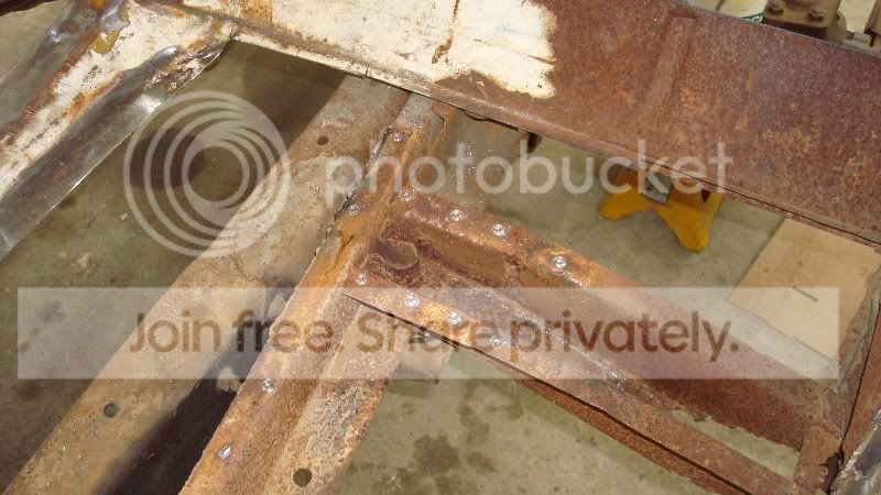

I found some really good info on chucks chevy page. Here is a cross section of the front floor support.
After thinking more and more about this and seeing these photos I'm thinking the way to do remove the front floor support is from the top not bottom. I would need to cut into my floors. This would be alot easier then trying to raise the body and take out the floor support from the bottom. Thoughts?
